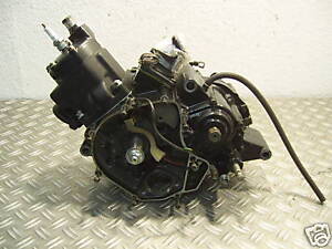

    \ but I wish they would start again as there is no way this KX carb is going into the RS frame without a fairly major cut & shut.
    Problem is the case reed conversion is too low so I'd need to run the PWK at a 40 degree angle which ain't going to happen, or accept a bit of a bend & some unwanted length as a compromise but at least get the PWK carb cw solenoid. . . except the frame needs a rethink. It could almost work if I assembled it & fit the engine to the frame. . .but that means dropping the engine for a jet change & even I think that's unworkable.
    So now I'm stuck with the poxy RGV carb & trying to think how to make an external Solenoid PJ conversion. \
    Quote Originally Posted by speedpro View Post
    That shock mount crossmember is a problem for sure. I have looked at all sorts of options like cutting it out and moving the shock to the side and even rotating the engine and mounting it forward with the cylinder near vertical, possibly with a jackshaft. Moving the engine forward needs more investigation though I see problems with chain geometry and possibly clearance to the front wheel
    Kel and Bren already sidestepped the issue.
    Now You to are scaring me..its bad enough me head won't fit.

    its an issue. With your taller reed position you will have better options. Nigels RG150 engine/carb fits in ok, or so it seems, he had to do a bit to make the engine itself squeeze in.
    I have got both here courtesy of TZ, i will post a pic of both side by slide. the KX has a venturi inserted for 24mm throat.
    I think the rear mount of the NSR engine will prevent a short short straight intake without a remote float anyway.

    Did you consider the giant air bubble in the cooling system above the red line?
    Yip after you said about it. It has a NSR250 front head on it at the moment. The NSR125 one Lozza sent over likely wont fit the NSR250 cylinder.
    (Thanks Bren for checking that for me after i told him to buy one cause it would)
    But i plan on using this one anyway.
    But it is the talking about it stage... i need a engine to be ferried down here.............
    Before anything can be nailed down.....

    This PJ stuff is all becoming a moot point atm. as there is no way this KX carb is going into the RS frame without a fairly major cut & shut.

    That first picture with carb on engine would make me concerned Husi. I think you are not going to have space.
    MC28 looks good. Or is it MC21?
    He's the only one I've got.
