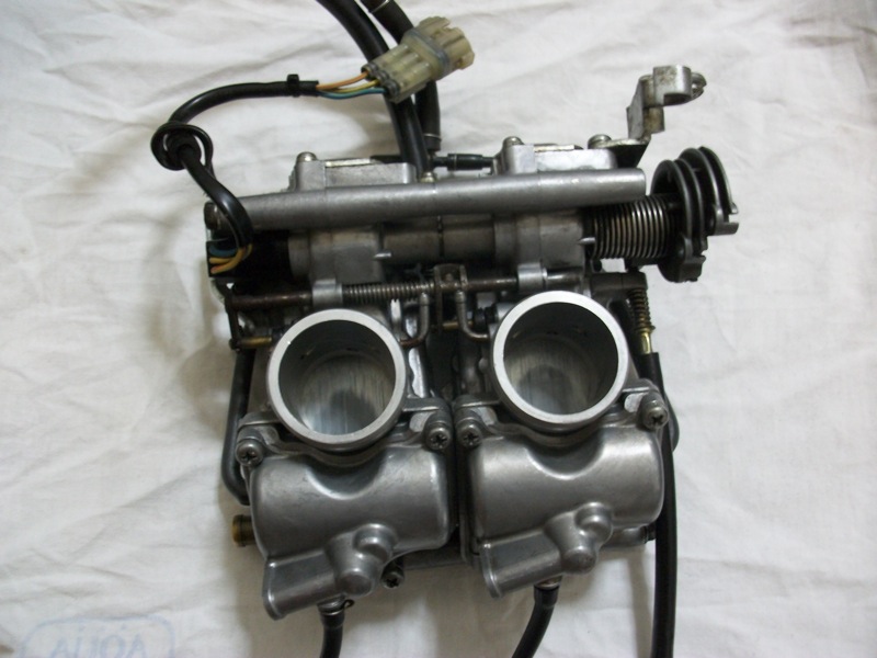

    I'll bite what is the 30 dollar TPS.is it off a car?
    I had a look in my carb box i guess the NSR was a remote one or mine are off a 21 rather than a 28 or what ever.
    OH edit Later it was like a car set up off the spindle
    I actually had a quick look at the PWK not sure how it works.....
    must google exploded diagrams.
    oh look at this KTM ran the PWK shorty with solenoid PJ but with a greater downdraft
    but still the SX is twice as much as the YZ.re KTM It may be hard to see in this picture but it measured right around 28* on the SX.
    Pretty sure Wob mentioned something about mods to the pick up as well as the PJ inlet earlier?
