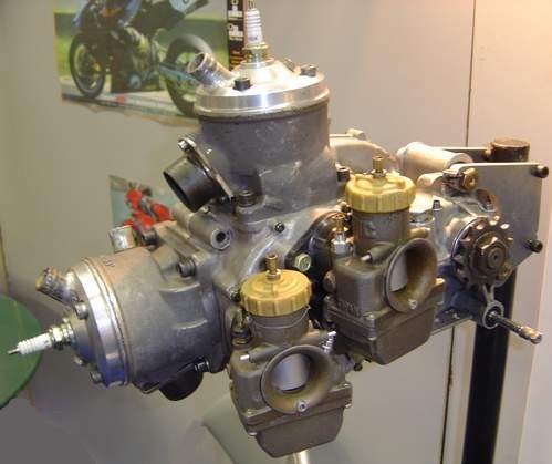

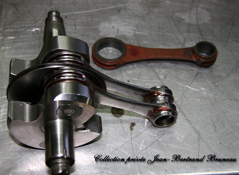

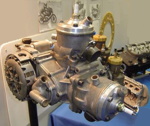

    I guess no one did.......
    But has anyone such as Jan Frits or Wob tried?
    I guess This is how the crankcase was sealed so it does have the odd modern application.
