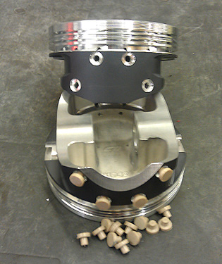

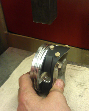

  11. #24176
    Trying to think back into the box.
    Quick easy experiment #2. If you're uncomfortable with adding a ring to the bottom of a piston, you could do a quick and dirty run with these.
    Hole in skirt (front & rear) to let ball protrude. Countersunk brass screws & nuts to adjust. (Could also add some springs or rubber, for a tiny bit of pre-load). Should roll in and out (over/through?) inlet/transfer ports, if required. Or use 2 one on either side of port or piston cut-out.
    Similar PS applies: don't expect it to last for more than a couple of minutes and don't use your good engine.
    A couple of back to backs (without & with) should disclose if any significant benefit is available.
    (15 KW in the Ricardo tests, assume that's per piston so +66% for the 125, worth a look?)
    Remember though, it was only 15KW peak at max piston speed so any improvements will be averaged.
    PPS, keeping the piston square in the bore might help those Wisecos survive better too.
    PM me if it works. Don't sue me if it doesn't.
    The screwed on ball bearings might be a bit rough, even for me.
    How about Brass brake shoe rivets? Brass Thumb tacks?
    How about Teflon buttons, shaped like thumbtacks, countersunk into the skirt?
    Quick & easy to do, should give enough life for a few runs before it all turns to poo.
    Works for Harleys on Nitro.
    Credit for the pics to this site: https://www.rbracing-rsr.com/bulbenefit2011.html
    Cheers, Daryl
