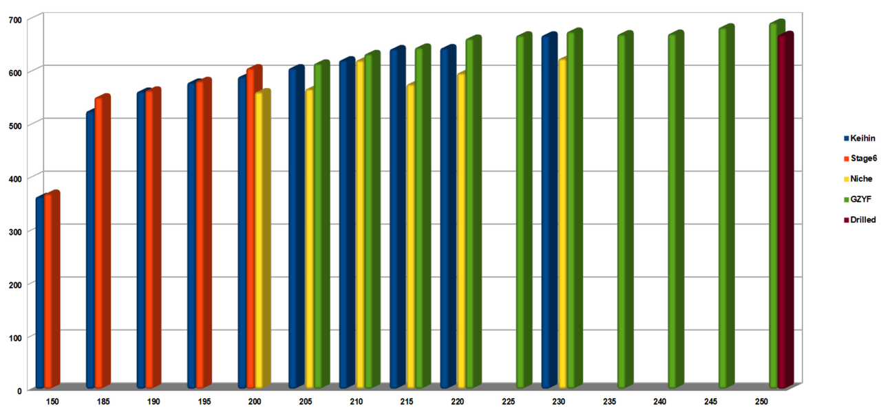

    In case this is useful for anyone, I bought a few more main jets for my PWK and spent some time testing jets that overlapped each other in size to see how it turned out. I got some real Keihin jets this time. Turns out the ones that I thought were Keihin (with the oddly ultra rich 210 jet that I showed) were Niche Cycle.
    2L bottle with bottom cutout, upside down. Cap tapped for hose barb, epoxied in because the caps today are so thin that it won't seal otherwise. 3/16" hose > shutoff > 3/16" hose. Main jets fit well in the hose. 24" from end of hose to top of water level. Water level marked on bottle so I could make sure it stayed the same for all tests.
    This is what I came up with. I think the flow numbers are probably somewhat arbitrary. I've got 24" of water above the jet, not sure on volume. If you tested with more or less water you'd get different results. I just wanted to be able to compare what I have rather than worry about some standard. I almost got wrapped up in a project to build a rig that would keep a set height of water above the jet at all times and horizontal exit flow at the jet after reading about Ford Zenith main jet testing and then I thought... you're still waiting to order a cylinder kit (circlip came out and trashed the current one with a brand new piston)... why spend money testing these things and turn it into a whole thing? I assume flow would be greater with water level always constant instead of draining, possibly changing results with larger jets more than smaller... but I think this comparatively simple method still tells a story.
    I don't have full sets of all jets, so that's why data points are missing. GZYF are the amazon jets. Flow numbers are ml/min. All tests were 20 seconds. 3 tests gives a 60 second flow figure. Better to do 2-3 tests to watch for inconsistency than to do 1 60 second test for each IMO... and I'm transferring out of a beaker and into a graduated cylinder for more accurate measurement... which takes a lot of time so doing 3x the volume multiple times would greatly increase time/effort. I assure you, it's not just pour in and look. I'm tapping and smacking stuff trying to get air bubbles out and it's a whole process.
    Niche Cycle jets are to be avoided! They are the leanest of all of the jets, but even worse than that is that they have a huge spike at 210 and otherwise there's only minimal change from 205 to 215.
    The amazon jets aren't awful... but then 235 and 240 flowed less than the 230. Not by a lot, but it's dangerous to think you're adding fuel while reducing it any.
    Both Keihin and Stage6 jets seem to go up at a good rate without anything that alarms me. Stage6 jets flow slightly more than their Keihin counterparts and their flow rate change doesn't look as steady. I think both are just fine choices though.
    What I think I learned is what I've known for years... go with big name brand jets and buy as many as you can from one manufacturer. Also, orifice size is what we usually think about, but entry design/size matter quite a bit.
    Example 1) The 210 in the Niche jets that flows way more than the jets around it. Orifice size falls in line, but the entry on the 210 is huge compared to the others.
    Example 2) My drilled main jet, 2.5mm (250) flows less than the amazon 250 jet. The smaller GZYF jets flow as much as it does. The drilled jet is one diameter all the way through. The others have a larger area at entry.
