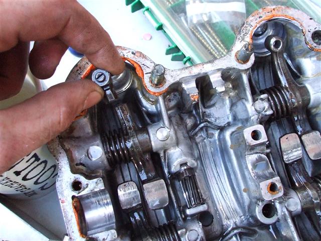

    you don't want this happening
    http://www.kiwibiker.co.nz/forums/pi...ictureid=15083

    Quote Originally Posted by hmmmnz View Post
    I have no idea what i'm looking at in this picture. Someone will have to explain it to me.

    It is a broken rocker arm.The piece between his thumb and forefinger is the adjuster which was most likely set to close and the pressure when the valve was opened was too much then...snap!The other end of the rocker arm is the cam follower.
