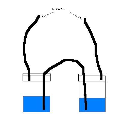

    as for balancing, also an easy job, very very easy compared to shims
    you need to buy or make a balancer though heres a pic of what i make, takes all of 10mins
    Photobucket
    and works a treat, remove the caps on the vacume nipples and connect, start from the center carbs and work out, balancing as you go, (some bikes you balance from 1 side to the other, you'd just need to check the screws and see how it works)
    have fun
