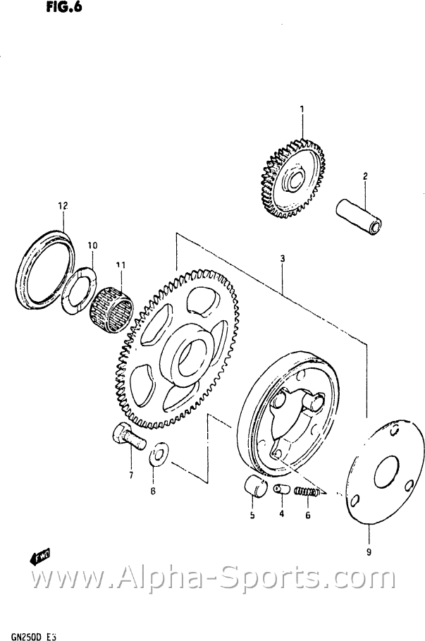

    The bolts have come loose and torn thread out of the front part of clutch. The clutch housing is damaged (fucked) the only salvageable pieces are the 3 roller bearings which are in good nick
  12. psyguy
    psyguy
  13. psyguy
    psyguy
    is this what it looks like?
    if it is just the threads you may be able to put oversized threaded inserts in (but not helicoil)
  14. jmk
    jmk
    I need at least 7 and 8, 4 and 6 and whole housing by 5,4, 6 (these are must haves) preferably with piece that bolts on front
  15. KiwiGs
    KiwiGs
    I have good 4,5 and 6s, yours if you want them.
