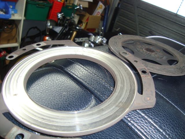

    Well the R65 has done 7 months of daily commuting with almost no maintenance..... just before Xmas the clutch started to slip and the tranny started to complain, odd as I don't work near K road.
    I got the Guzzi running well enough to take off the hoist and start of the R65.....three days of commuting by car had strengthened my resolve to get it going.....a day on the scooter confirned that 200cc was not enought to cut it on the motorways of NZ's engine room.
    By now I stated to realise that I must be the first in here since 1983 as all the bits that get put back on were still there.....
    Original German BMW grease....Concours Judges would give me points for that.....
    Check out the Groovyness .....mmmmmmm
    Nicely polished rivets and the judges would never even see them....
