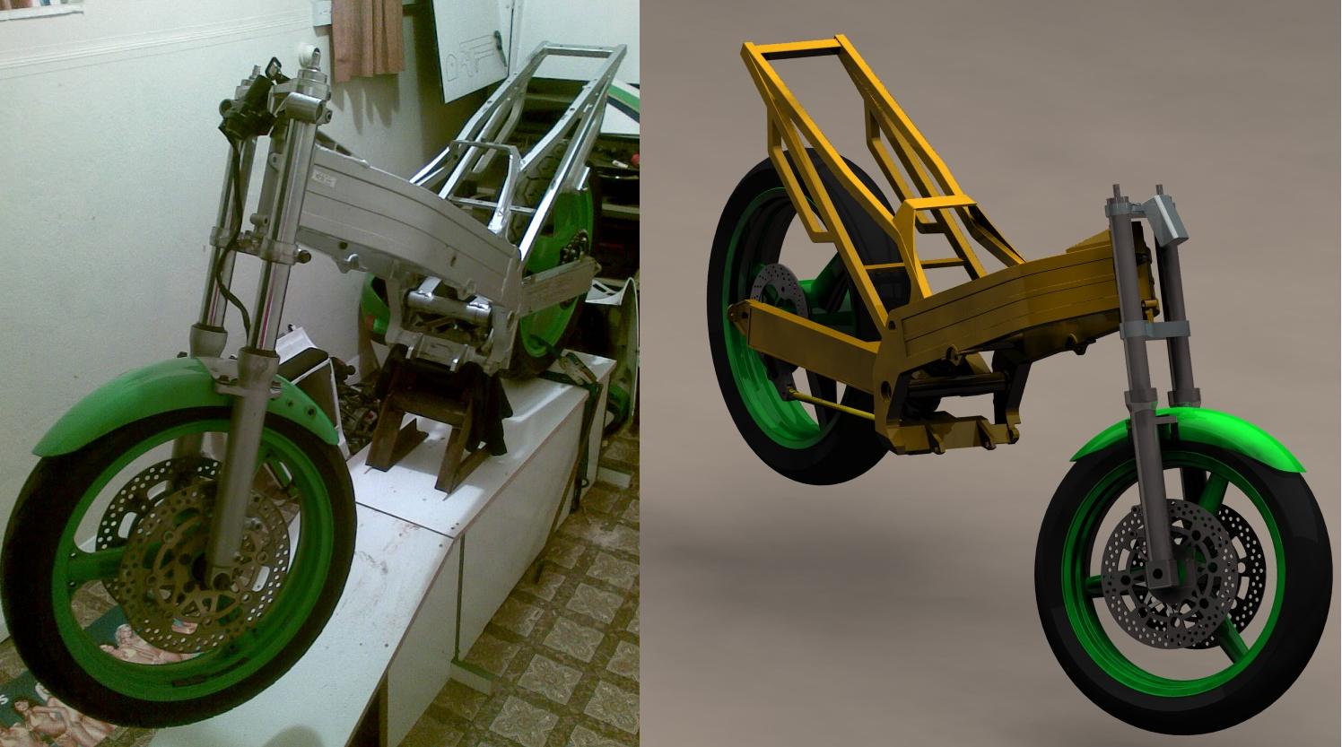

    Firstly i ripped out engine, cleaned and CADed up the rolling frame.

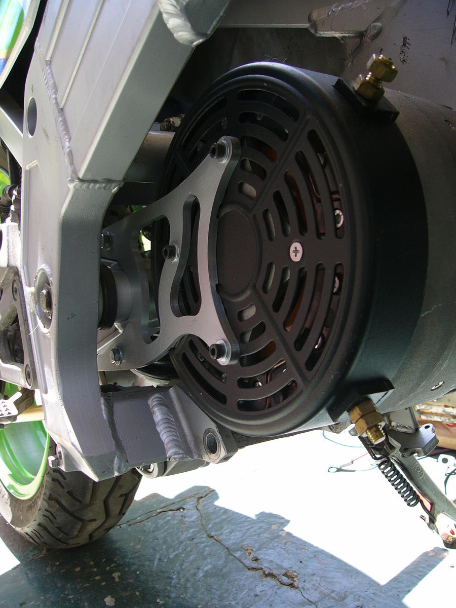

    mounted the motor onto the swingarm itself as it doesnt weight much and this eliminated the need for chain slack, thus slightly increasing efficiency.
    ull notice some cnc maching on the mount, courtesy of my part time job at massey uni.
    also got chain and sprockets custom form nz sprockets, 14tooth over a monster 68 tooth, i machined 4/5 of the weight out of the 68 tooth and mounted in place of the original
