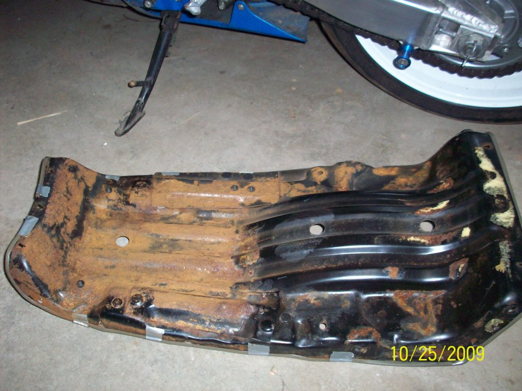

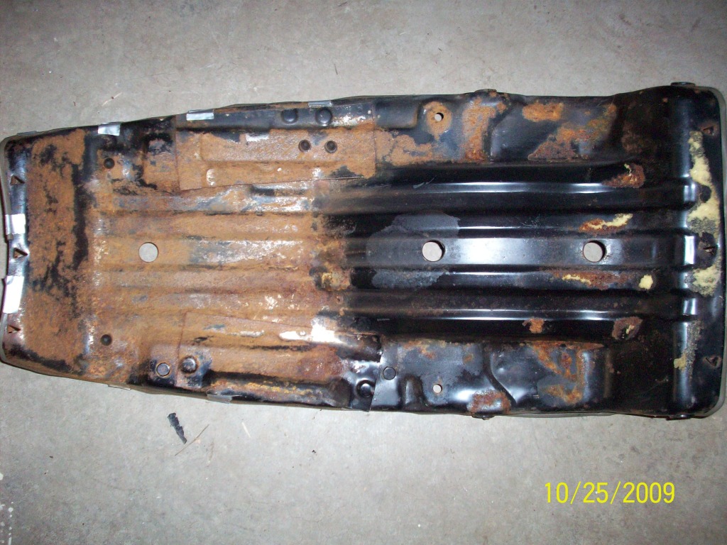

    this is the one i was looking at. the guy swears it's only surface rust.
  5. flyingcrocodile46
    flyingcrocodile46
    I'd be tempted to run with it. It does look like surface rust. However as the freight is so high, I'd insist that he spends the 10 or 20 minutes required to clean (surface rust) and show some more pictures of it before committing. If you offer him an extra $10 (if you proceed with purchase) and he genuinely believes that it is only surface rust... why would he refuse? (unless he's not really sure it's ok)

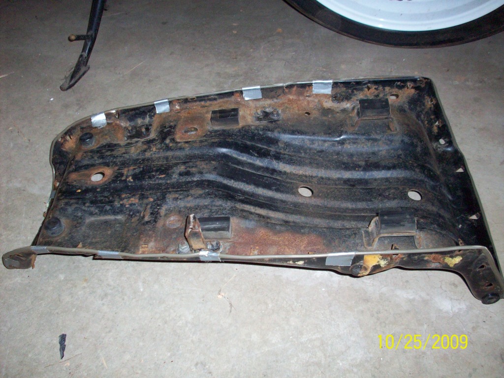

    I'd be a bit cautious with that pan. It looks a bit buckled and bent on one edge, as if it's had an impact and been straightened. That would weaken it and as it's on the bottom lip, you may end up with exactly the same problem.
    If it's just the bottom edge that is broken, do you reckon there is enough meat to pop rivet a small plate across the broken area. Maybe even tuck a second piece up behind the edge of the padding to form a double splint???

    It looks OK Psy. The only areas that have had a bit of treatment are where the hinges mount up. Very minor though. How does it compare overall, to yours?

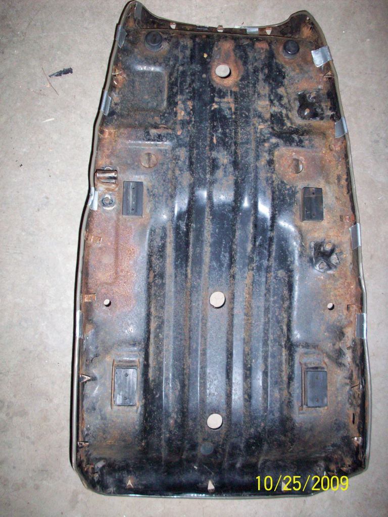

    croc, buckled - yes. split - no. that's a triangular tag that bends to pierce the cover and then bend again to hold the cover in place. some of mine are broken altogether.
    my seat pan is rusted/broken on that exact "lip" that you mention, that's why i think it would be a difficult repair, unless a strap of metal was used along both sides but that would make the lip quite thick in that area and that would show when the cover is stretched. also, the hinge is like right in the middle of where the lip is broken so that complicates the repair...

    a couple more pix
