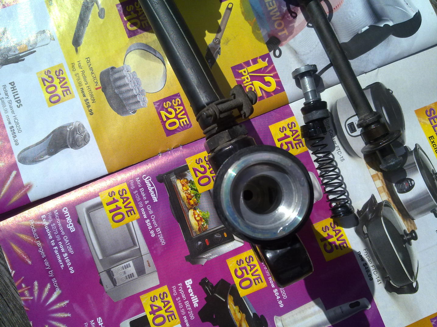

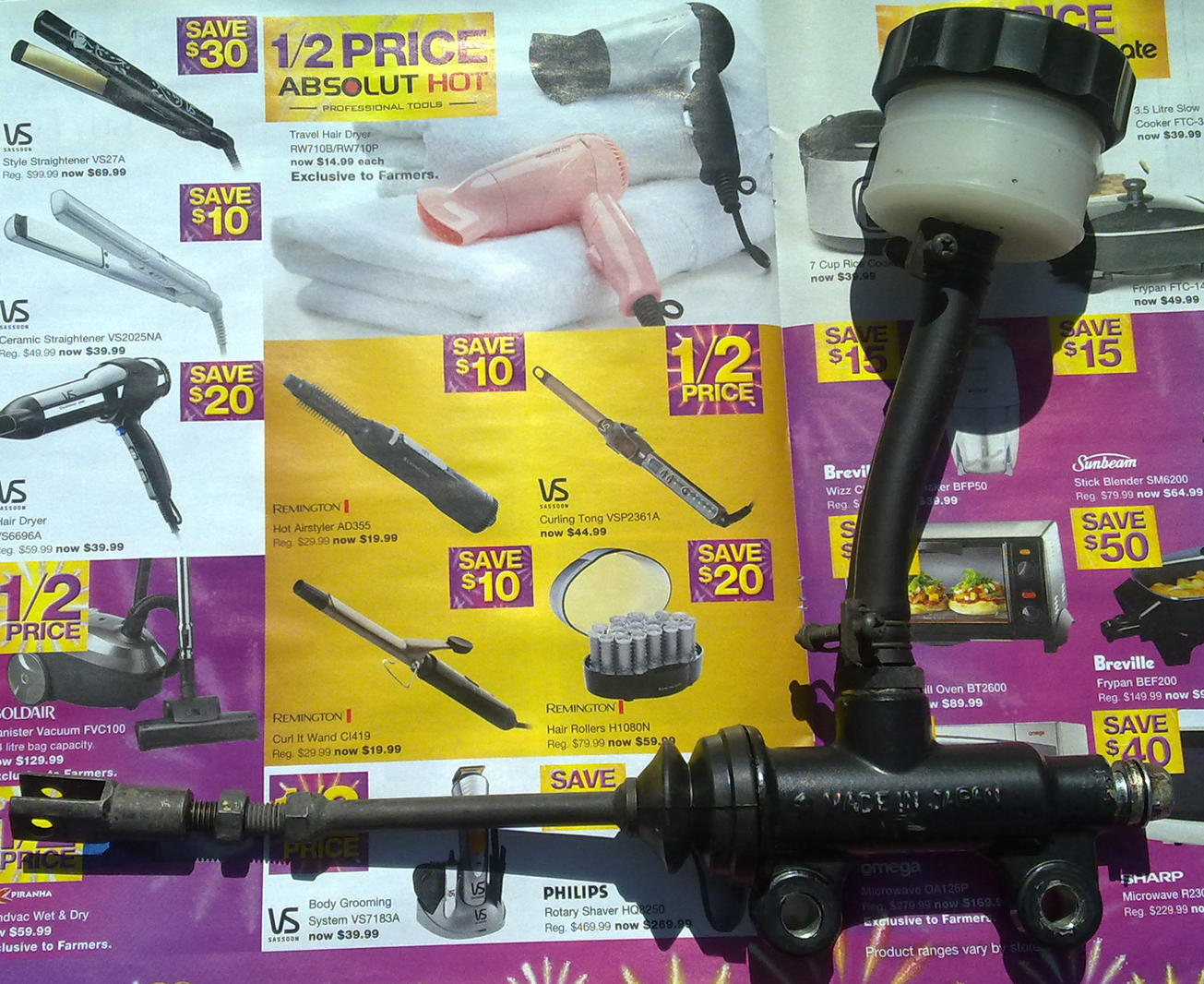

    JMK I might have what you are needing. The threaded end of the link rod is a little bent and paint bubbles around where the hose connects but otherwise looks pretty good.
    I don't know how old it is or when last used but if you are really lucky it will bolt straight on and solve your brake problems.
    You can have it for $50. Let me know and I will give it to Uncle dodgy or croc to take down. I am sure they would be happy to detour over to your place for a cup of coffee and bacon and eggs brekie

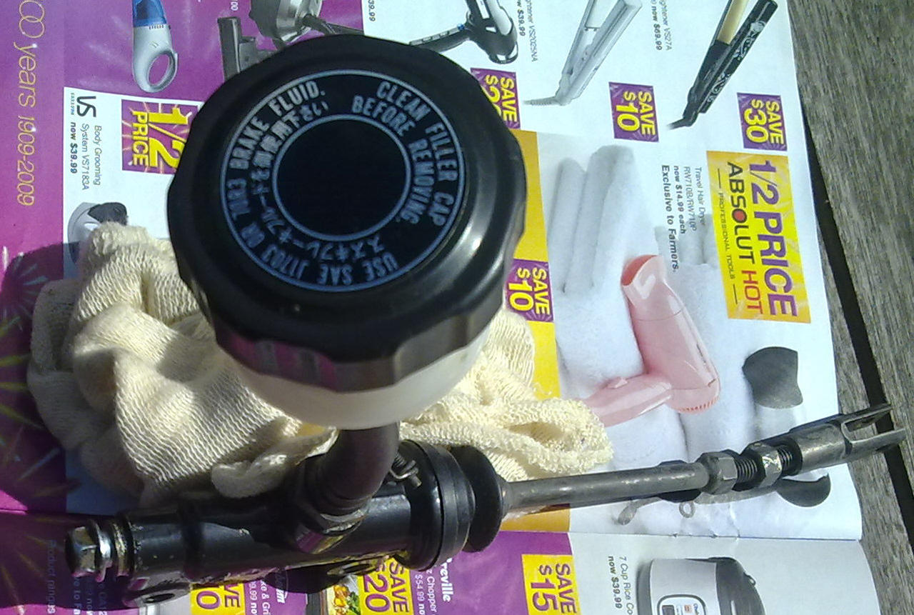

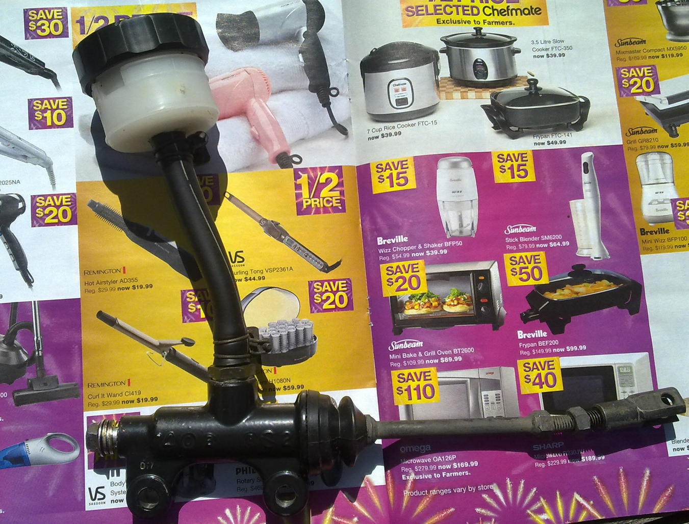

  10. Slowbionekanowbi
    Slowbionekanowbi
    Bloody heck! Uncle Katman didn't tell me you were gay. I'm a happy boy now.
    I stripped down and cleaned it out for you.
    No Psyguy. I am talking about the MC for the rear brake. Not what you're after
    The cylinder is clean as a whistle (ignore shadow circle half way down as it is a trick of the light and moves around depending on the angle where you look from) and the seals look fine.
    It should work fine without new seals. Like I said - bolt her in fill and bleed her and away you go.
