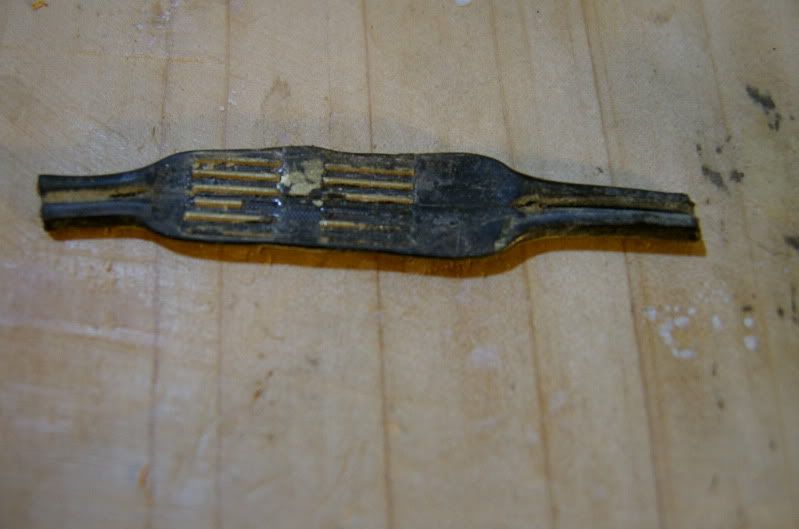

dont ask me to help, guess what this is
well I'll tell you anyway ,Mountie and I spent about 2 hours trying to figure out why my heated grips kept blowing fuses and I was just about to flag it and take a can of HTFU with me instead ....when I found this ,I'd had the bars off to do my fork oil and clamped the HG wire when I put them back on![]()
Hmmm i do belive you have squashed the wires....![]()
