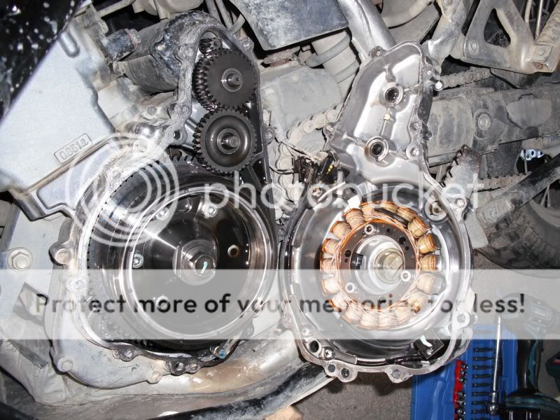

    Just come in from the shed - pulled the alternator cover off and my bike (build date 04/07) is one of the deep hole models. It could be quite nasty if the shaft moves right to the bottom of the hole in the outer cover (and there is nothing to stop it moving, either) - theres nothing left to hold the inner cover side thrust washer in place except the oil film. It could go down and stick to the alternator rotor magnets (if you're lucky) or it could get into the cam or balancer chains (less lucky). After that who knows what shit it could do. Worth checking.
    I'm going to bring it up with Motorad and see what the position is with regard to warranty, but I wouldn't hold much hope.

    Drain the oil, or tip the bike on its right side. Remove the gearlever, remove about 8 bolts securing the cover. I removed the sprocket cover (3 bolts) but you may not need to. The rotor magnet will pull the alternator coil inside the cover back in so it takes a wee bit of levering (there are tabs on the cover to get something behind, don't stick blades into the gasket face and cause future leaks) . If you are careful you should get it off without damaging the gasket. There should be four thrust washers (2 per idler gear, one each side). The top shaft doesn't have the problem, the bottom shaft does.
    Wattman (of Thermobob fame) has been collating VIN numbers from contributors to KLR650.net. At present it's looking like ALL '08s and about 4000 '09s are affected - about 20,000 bikes.

    DId the starter gear check this morning.
    1. Tip bike over so don't have to drain oil 200kms old.
    2. Take out 10 bolts - NOT the dooickey adjustment bolt - & gently pull cover off looking out for gasket. What we are looking at is the second gear down. This can be easily pulled out & see if there is any damage to the shaft housing on the engine side. Mine was perfectly fine. There is a washer on the engine side so don't let that drop off.
    3. I cut 9mm off a 10mm high tensile bolt to use as a spacer & dropped it into the deep hole with a dab of grease to hold it in while the cover is fitted. The spacer stops the starter shaft from moving across into the deep hole & dropping out of the engine side causing a clusterf**k
    Let the nurse carefully scrap the silicon crap from the cover & case surface left over from the last time I opened it up- won't be doing that again.
    Let the oil drain back down to the bottom of the engine & started it up. - no bad sounds so all seems good.
    It should have only taken me 1/2 hr but getting the silicon crap off took about an extra 1/2 hr
    pretty easy really.

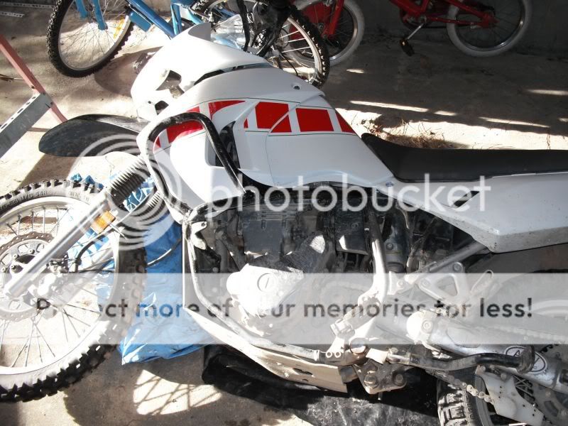

    thanks for the pictorial Padmei
    Did you get sick of green or did you secretly want a tenere?
    Bit of both really. All the panels were scratched or broken & MRS Jatz' Tenere is the coolest bike around so thought I'd copy it. Any scratches from now on can be touched up really easily. Had a few strange looks from passing riders trying to work out what model yammy it is
