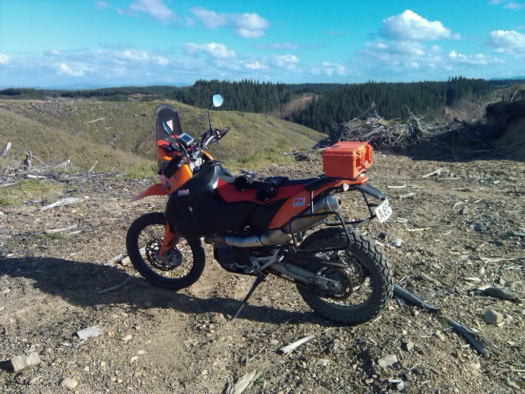

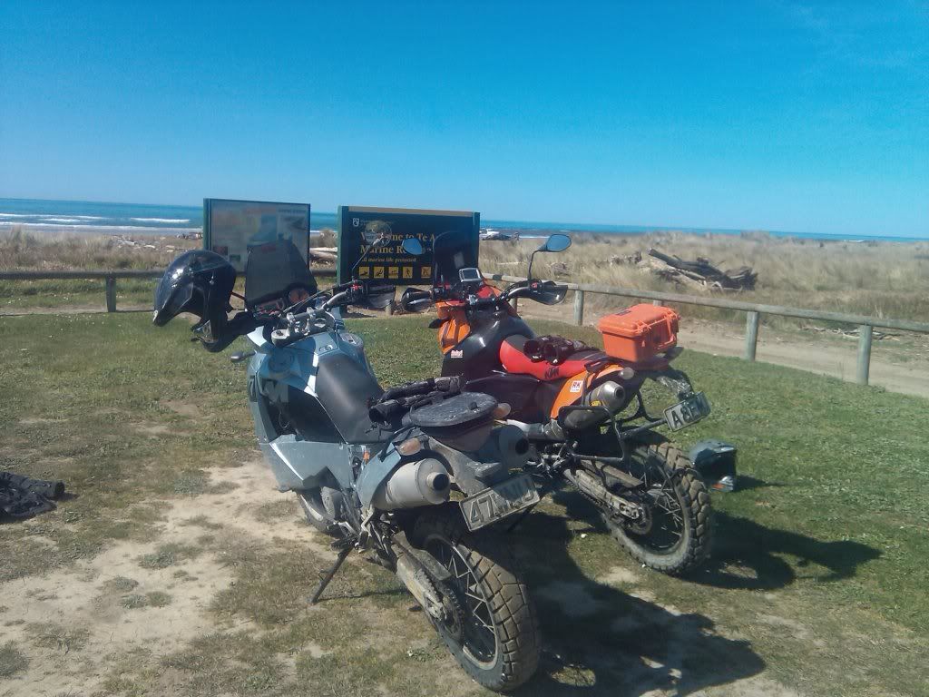

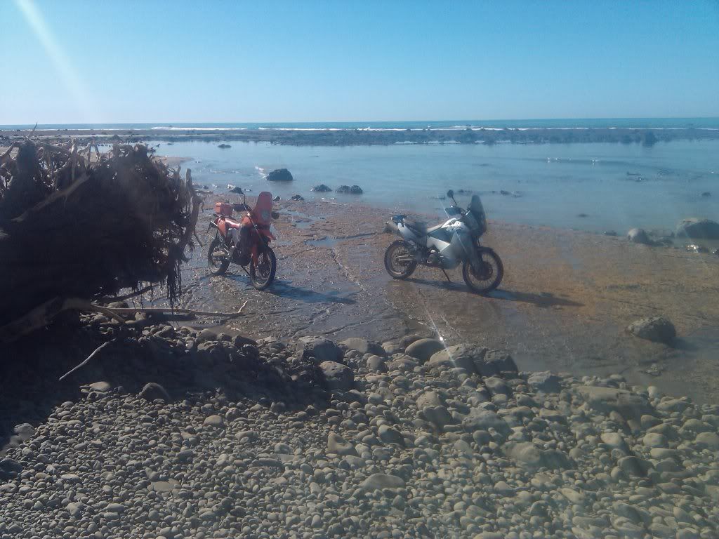

    Black head beach...we got here after some careful navigation around major slips which have blocked the beach access...low tide access only!
    good to be back riding with the 950...1st outing in over 4 months !
    ....wherezz that track go

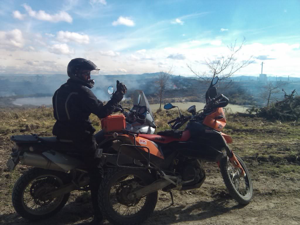

    ....give her the berries Jimmy fantastic days riding!!

    The problem is at Aromoana...BIG slip right to the low tide water line..we managed to limp our bikes past it over the papa and got round to Blackhead but impassible at anything past low low tide!...let us know next time you up this way...be great to catch up for a burn
