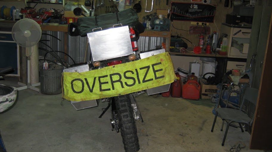

you want to borrow them,,, yea not the best place to keep my gas i guess,,,,,
JMJ
