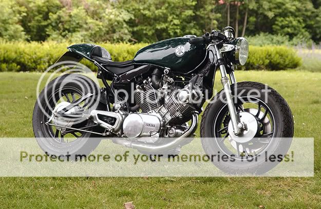

    Cafe racer
    Yes
    Looks like it has a rear wheel fitted to the front, the big front tyre looks a bit wank but the rest is nice

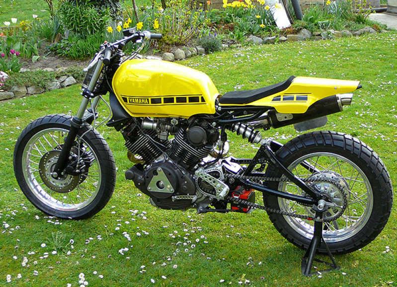

    .....chose one of these to flat-track, only because it was 5km down the road and cheap....all those who know more about anything than anyone else, reckoned it was a silly idea... too heavy.... shaft drive no good for dirt,power delivery etc....it beat the shit out of most machines that it came up against...(the bike,not always the rider)...
    18 inch wheels from similar Yam shaft drives of that era fit straight on......i threw away the cv's and put mikuni slides on it, tweaked the straight exhaust lengths til it wouldnt lift the front wheel on the line and had more fun than i could ever have imagined was possible for something like this.....in a lot of seasons of hammering it , one cam chain let go, bent a valve, missed one meeting and fixed it for $40.00.....probably one of the strongest jappy motors in existence....and the shaft drive didnt fuck with torque to the deck or try and stand me up in the bend, like most people seemed to think......and check out this......
    Yamaha did use the XV750 as a basis for their flattracker,so they saw some real competition use.This is an XV1000,not the real thing,but it looks pretty dam good to me.
