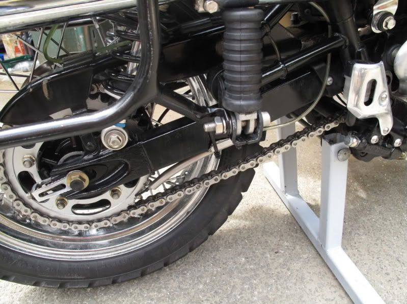

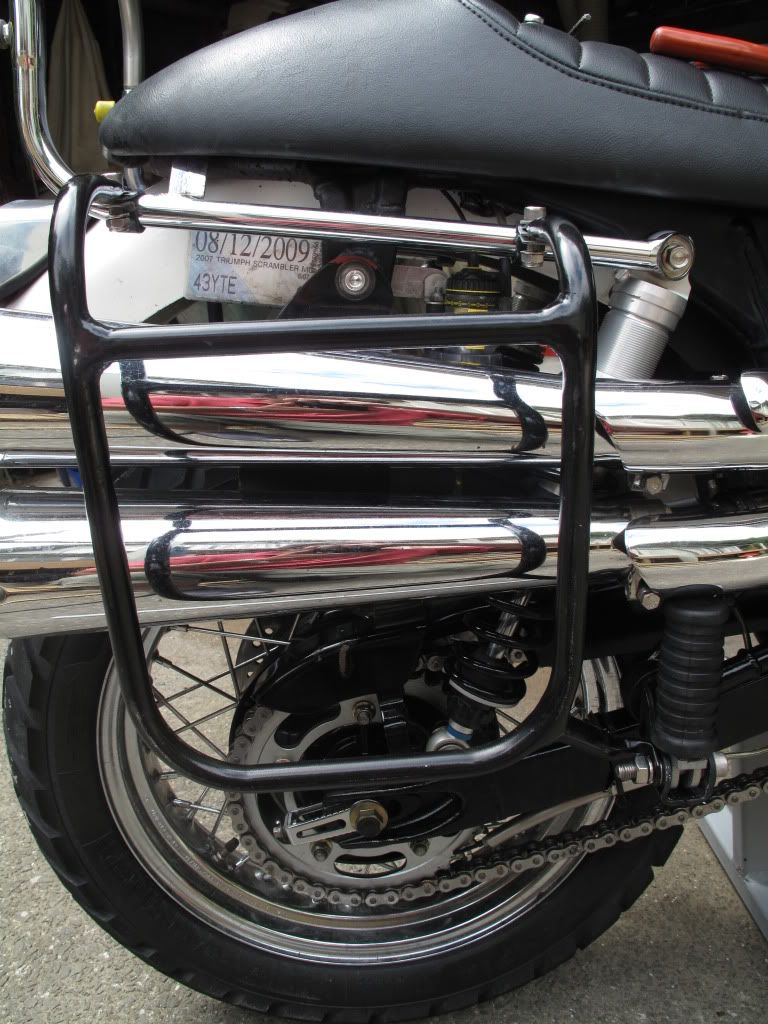

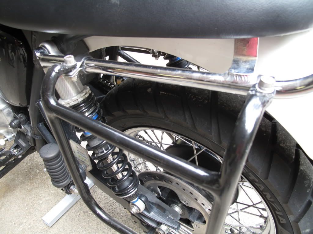

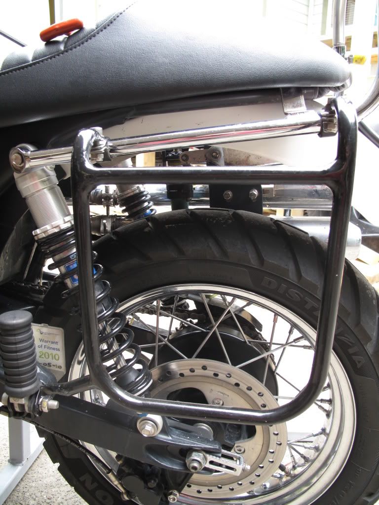

For panniers you will probably still need to make a rack of sorts to tie them to & keep them off the exhaust. As Eddie says the easiest way for the average handyman is to get some soild bar & a few scraps of flat for the mounting points, bend to shape & arc weld together.
The soft pannier racks I have made have been 1/2" stainless tube (worked well but prone to cracking eventually) Then 1/2" hydraulic pipe (worked well, bends nicely) then the most recent set for Rosie's new WR was out of 3/4 4130 Cro-moly tube (hard to bend but light & strong as buggery) Of course for tubing you really need a bender & a gas/tig welder. Most of the work is in making the mounting points.

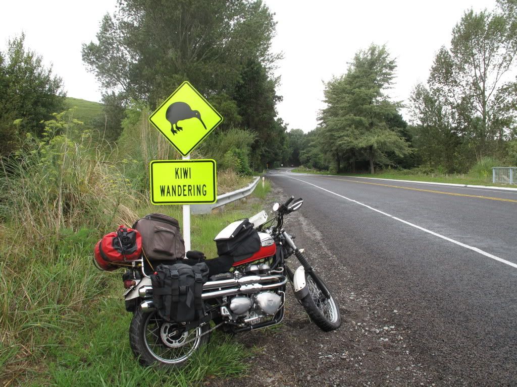

Panniers are Andystrapz expedition bags like Clints only cleaner cos I'm not allowed out much, Red Bag is from a camping store , about $40, fold over flap to seal so no zips, used it in torrential rain & no leaks.

[QUOTE=trustme;1129829539]Like this, red bag carries sleeping bag & lightweight tent
QUOTE]
Yes. Any chance of a non mounted photo? It looks like the bottom is mounted to the pillion peg. Yes?
