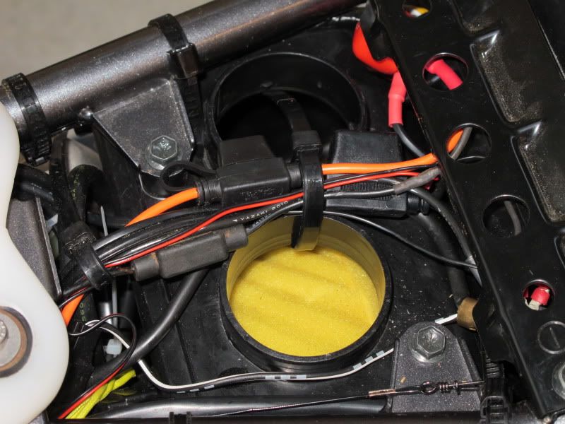

    Nordie, how much difference would cutting the airbox fully open vrs a 60mm diameter opening make?
    60mm is 50% larger than the carb intake so the velocity through the opening should be quite reduced and much less of a restriction.
    I was thinking of doing something like the below, but with only the upper hole in the pic installed. I don't really want to butcher the entire airbox.
  15. #450
    2nd March 2004 - 13:00
    FransAlp 700
    14,484
    It'll be better but not as good as the whole top cut out.
