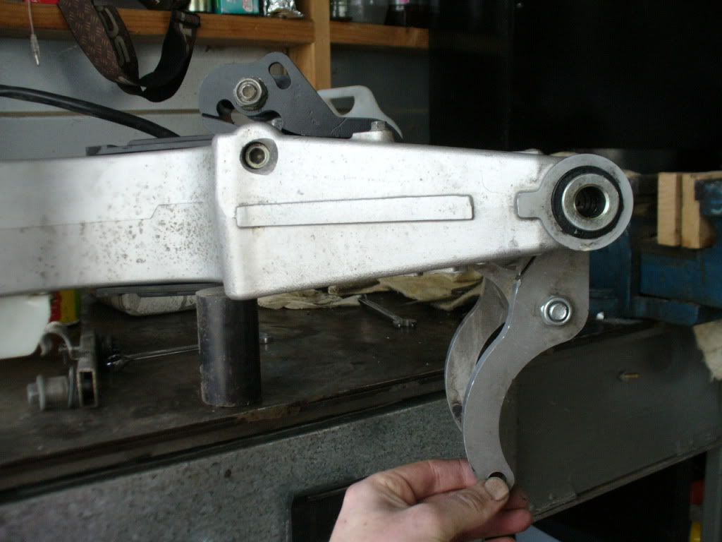

    Had the swingarm out the last few days, after cleaning got some better photos of the linkage installed on the swingarm. Looks like it has all held up alright, though there was a bit of wear on the roller bearing these are supposed to be rotated every now and then anyways, and it'll be good until the bearing are next due for a re-grease anyway.
    Suspension at rest.
    Suspension compressed. Shows the extra rotation of the link bit.
    Rigid mounts and link, rigid mounts bolt to the centerstand holes, and clamp up on the swingarm bushings at the top, they provide the correct location for the link's fixed end.
    Best view of the rocker. Machined in two halves, weighs about a kilo, only adds about 190gm to the unsprung weight (probably not noticeable with the other 25kg). Little slot next to the nut allows access to the rebound adjuster on the shock.
    Whole lot, so clean
