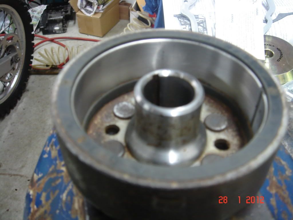

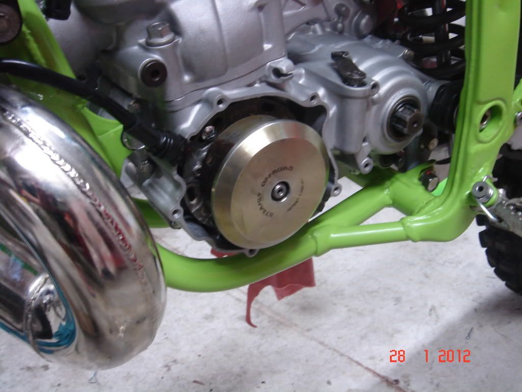

    So while I am waiting for that dam spring....(last post...) I might as well install the engine and the stealth fly wheel... OK sounds sooo simple. Small problem it will not screw on and after a few beers and 1hr + trying to fit the bitch I work out its a left hand thread. Gutted (who said beer and bike go togaether) But its fitted OK once I screwed it the right (left way) way.. (dam its just like the wife... got to screw it just.. yea yea)...... OK my ass 1hr + trying trying to fit the bastard. Not happy.
    Enough said... pictures...
    Photobucket
    Looks a little cleaner than when it was removed...
    Photobucket
    Scotch bright... does a great job... this was nothing but rust.
    Photobucket
    Left hand tread... MAN... I had both in the vice holding them square turning the new fly wheel but it would not work... next was 6mm tap to make sure the treads where clean and they were. Still no go. Then I thought.. left hand thread and bingo...

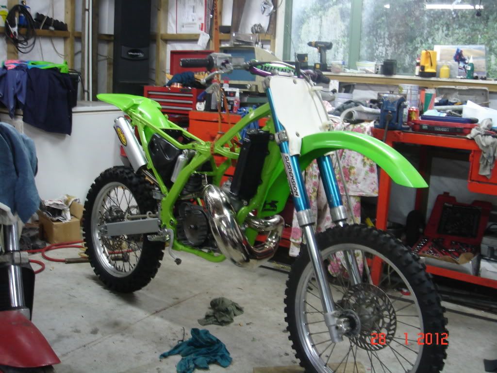

    Photobucket
    Got to say its starting to look like a bike.... 20 yrs old I might add.

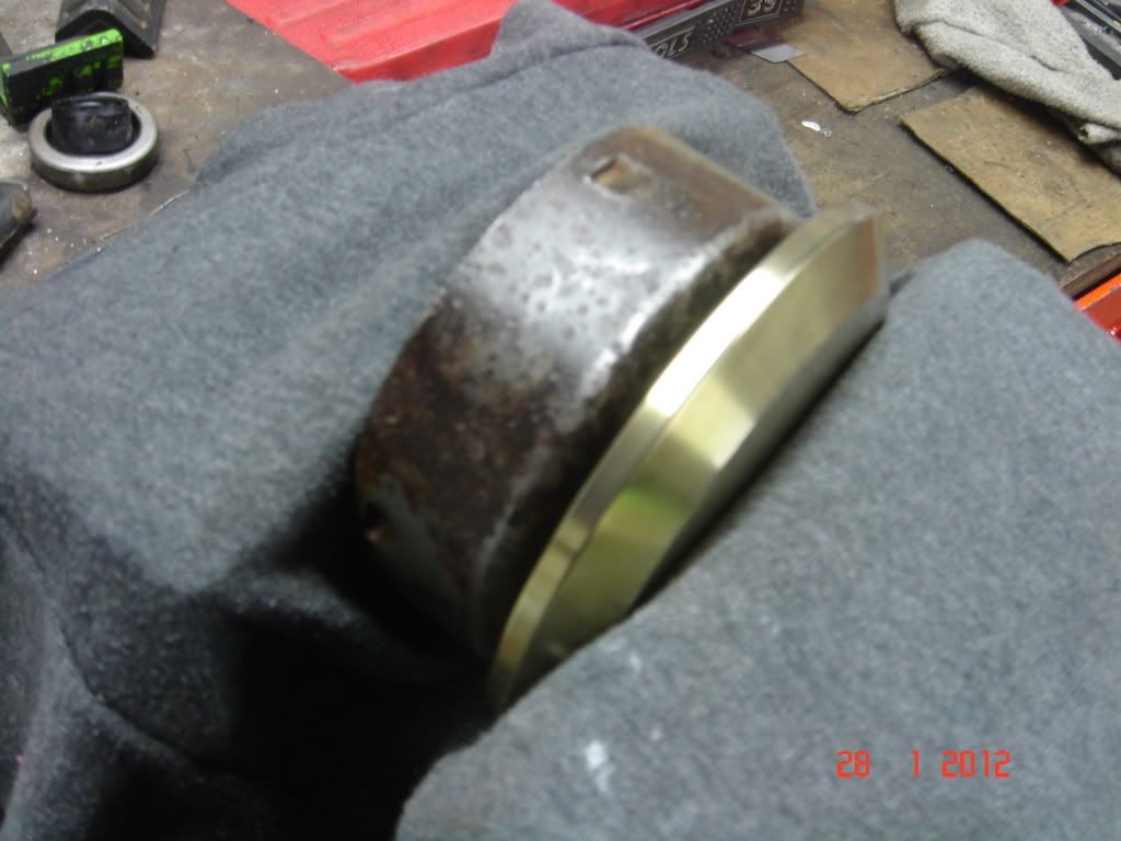

    New water pump impalla shaft would not fit... this was not good. I thought I had installed the wrong bearing so I removed it... then measured everything (next day) when I could see..! haa
    And mother fucker... shaft was over size... 8.02mm now even with a big hammer thats not going in to an 8.00mm bearing.
    so I gave it a polish ... and got it to the right size.
    Photobucket
    Photobucket
    remember what the old one looed like... and it still went... leaked coolent... small problem..

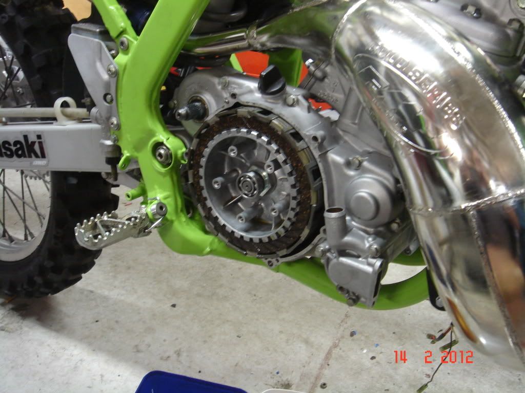

    Anyway that fixed and installed... on to the clutch...
    Photobucket
    Looking cool...

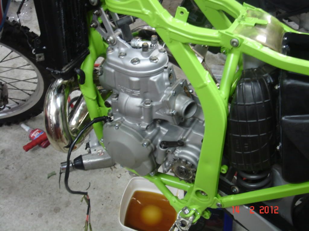

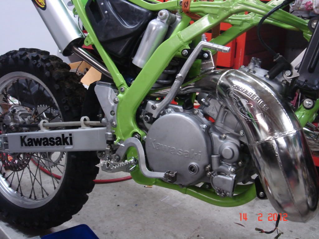

    mean while... work done...
    Photobucket
    Photobucket
    Motor is now closed... time to work on the carb and the plumping.... getting close I say!

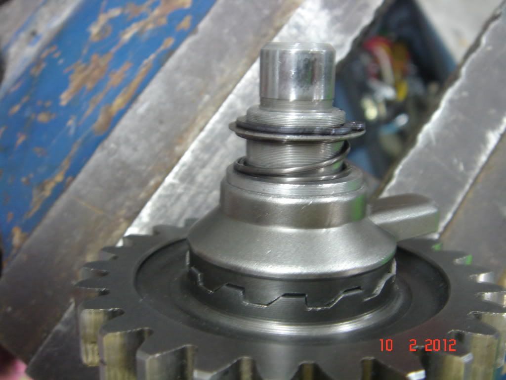

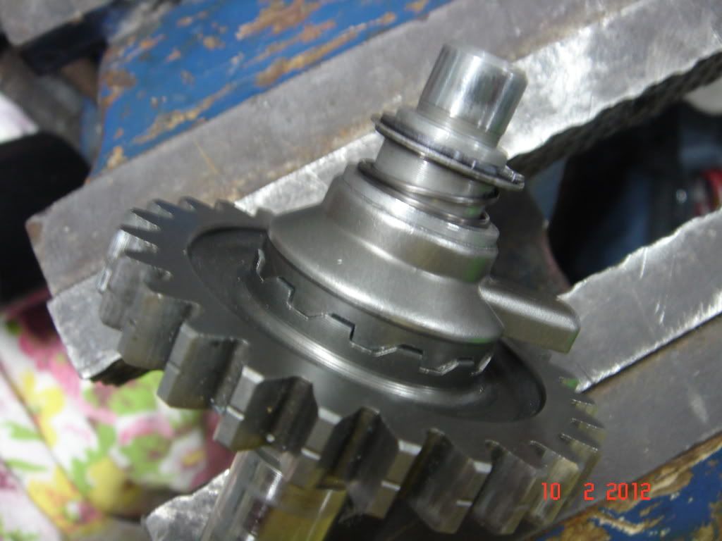

    And to add... an update on the kick starter... washer made to take up the 1.0mm removed from the gear surfaces... testing so far everything looks great and sound perfect... click click click.
    Photobucket
    Photobucket
    No burred over edges on the gears... looks dam good to me.. also a new spring which was 2mm longer than the old one so that will help. Like getting the wife a cut and tuck... works for a while but eventually its gona turn to shit! A then its time to get a new model...(lighter rear end... updated CDI and a beffier front end... sounds perfect) OH and no dam rebore!! ..If I can afford it! But I am happy with the repair and it will last quite a while as it was not a rough job with a grinder like some on the net. To be honest thats where I got the idea... just wanted to do it right!

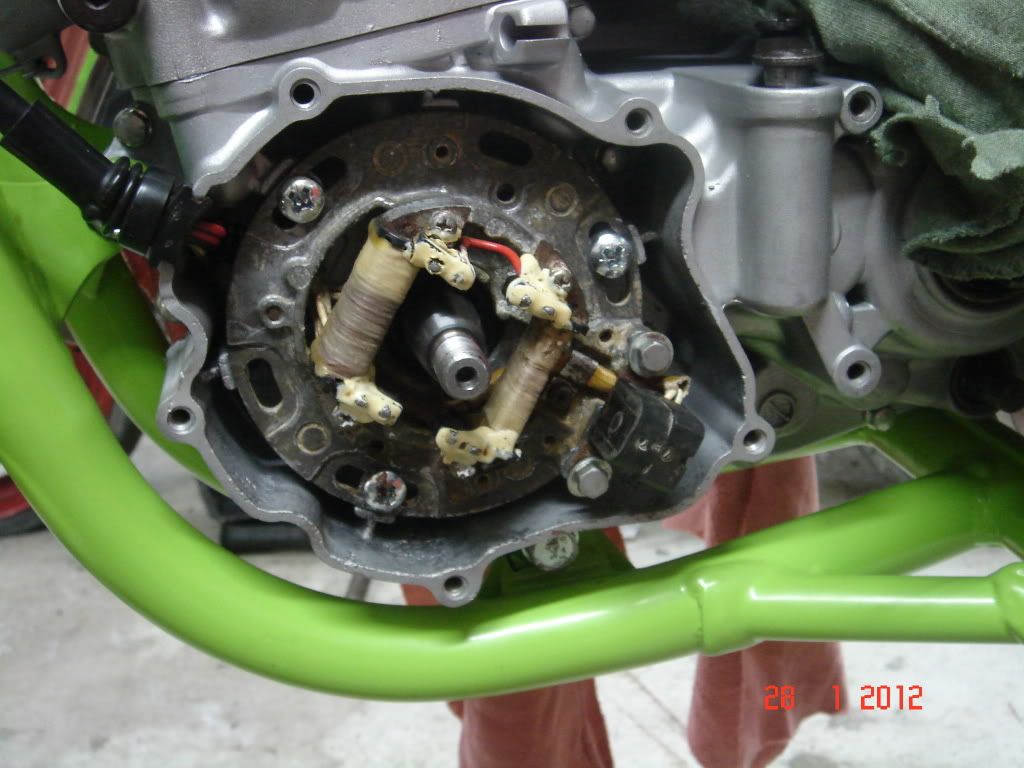

    For a while anyway... magnet on the magneto broke.. was looking dodge so I knew stright away when there was no spark. Another is on its way from themighty USA $120... here in 8 working days. Hope to have it going for the Hamilton kids camp out.... depends on my shoulder... munted A C joint some how. NOTHING to do with beer!.... who posted that?
