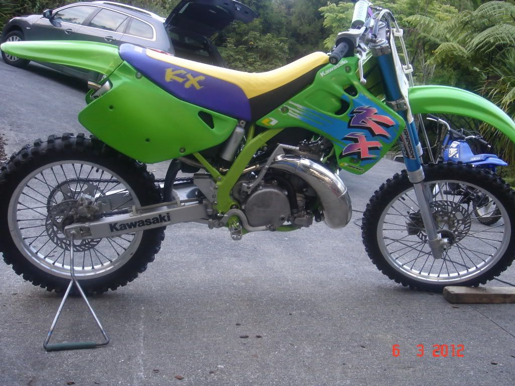

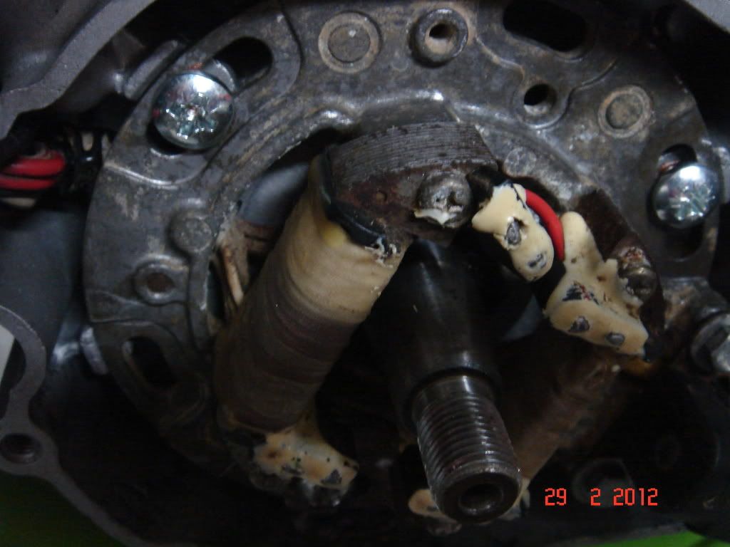

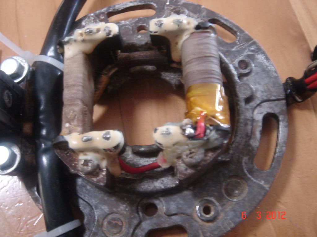

    Thanks Grant .... yes the KX was finished for the weekend and did not miss a beat.
    The magneto thing that stopped the bike had a broken wire and the one comming from the USA did not get here in time... What does one do? Ahhh yes phone mate who works at an eletronic company and he used a microscope to join up the wires with a jumper. A job well done and was free.
    Before repair.
    Photobucket
    After repair.
    Photobucket
    And for FREE... dam great.
    Bolted it on and bingo... Huston we have ignition!

    ready to go for the weekend.
    Photobucket
    Used as it should be... the kick starter did not miss once... WOW pleased about that. All in all there were two bolts that needed tightening other wise it ran like a dream. Now to get it to idle... I did not have time to look at jetting so thats the next job!

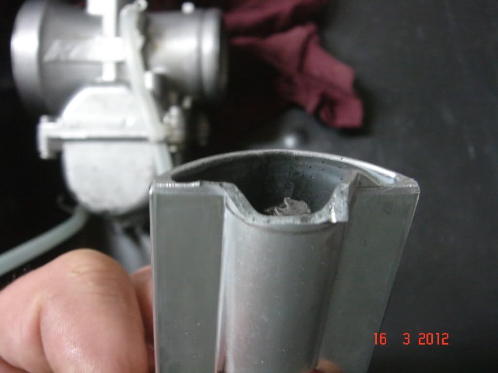

    haaa well well well..... won't idle... idle screw does FA.... Jetting must be FUCKED! yea yea yea....
    Internet... google search "KX not idle" down load 1000 post and only print 900 of them. I've read so much shit on jetting that I'm looking at the womens box with new thoughts.... what would a little jetting do to that!

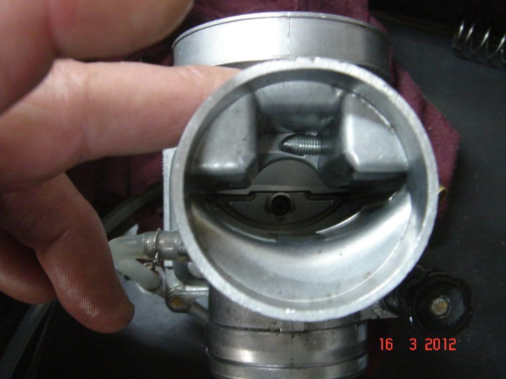

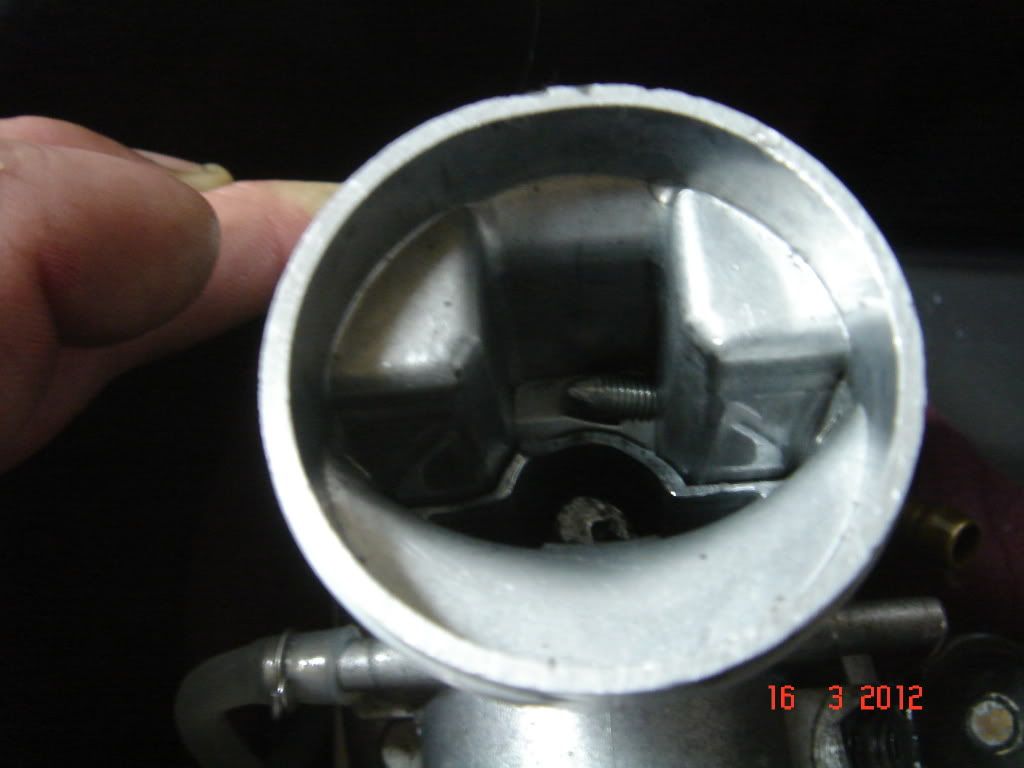

    My race bike... that road not dirt version has a oxygen exhaust sensor fitted so I can mointer the fuel / air mixture so I have a weeee bit of experance in the jetting game. So there are no plans to let the KX Beat me.
    So with my new found knoladge off I go HUNTING.... won't idle my ass.... OK lets open her up.... spread it wide .
    Photobucket
    Carb removed and time to start hunting... and yes before you start... I did strip, clean and service the carb!
    Notice the air screw.... have a close look!!! yep looks fine... next is the slide
    Photobucket
    looks fine to me.... now put them togeather and see why the little fucker wont lift the slide...
    Photobucket
    WTF
    Photobucket
    WTF WTF
    Photobucket
    WTF WTF WTF ...... WTF yes I did not noice this. WTF WTF WTF... shame.
    The idle screw is not doing shit in that carb... so before I start changing the jetting I think I will borrow / rob / steal / confiscated / scab / rent / highjack / win or dam it buy a new slide. All gifts thankfully recieved..... Oh and I take PayPal.
    One for the road...

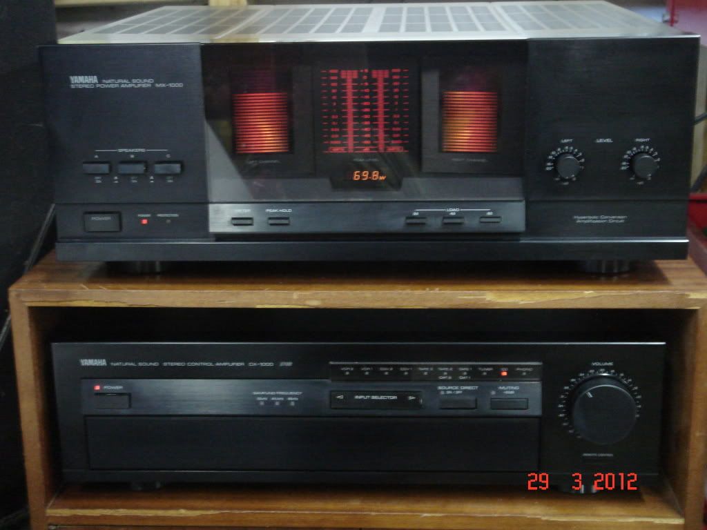

    Enter.... Yamaha AMP and Pre AMP.... yep that what I want... reviews are unbeleivable.... two days thinking about how I can have them and still be married...
    Yamaha
    MX-1000 AMP
    CX-1000 Pre Amp
    Ok means FA........ made in the 80's F off I hear you say.... but NO!
    weight... around 25kg
    260 RMS .... thats just plain mean.... haa makes me laugh just saying that number.
    YEP ... it is ... WOW and more wow and loud and clear..... un real sound and soo loud... the sound goes through you... weird feeeling.
    Photobucket
    might add tomorrow what I think of the turn table tomorrow after I report the tyre pressure on the KX... I am sure everyone would like to know how much the tyre pressure has dropped since I got the fitted!!!! stay tuned....
