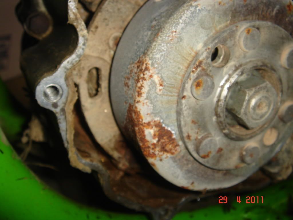

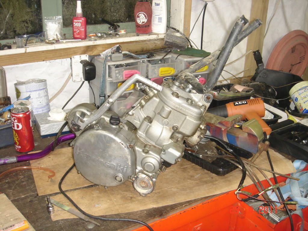

    A few beers and a little more dismantaling .... aim is to get the motor out... easy... had to go slow to avoid feeding the kids.....

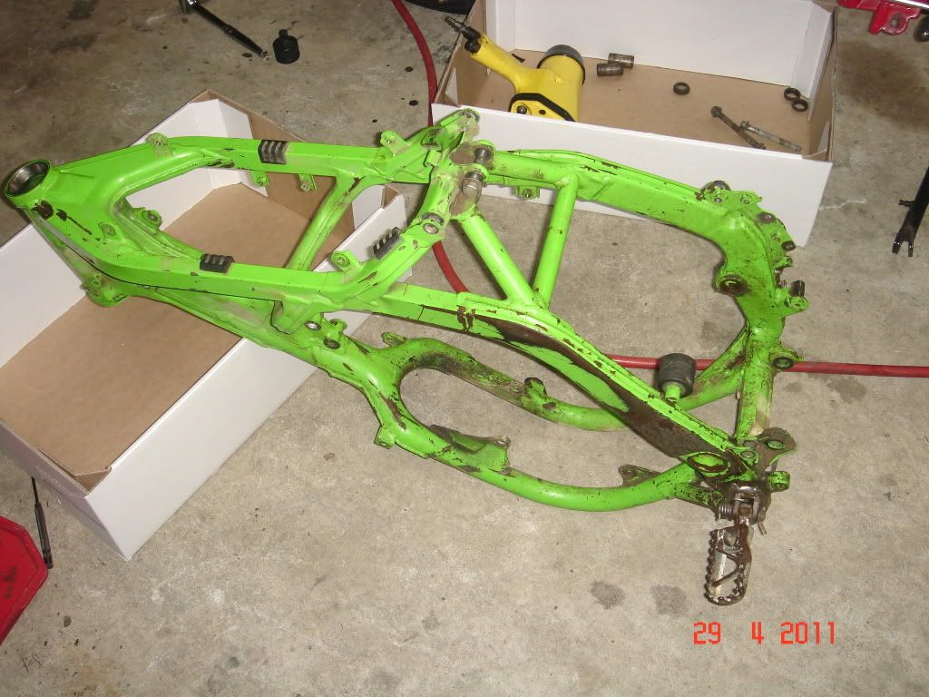

    Dent in the frame that needs to be removed... tack a washer at the impact point with my tig and use a puller to pull it out. The key is to weld the washer on the exact impact point... that way the dent will pull out. Plan is to over pull it and pein it back and file smooth. This is to powder coat the frame... other wise .. bog and paint. I like the powder coat option.
    picture too follow when I need to go back to the shed!! to find the SPOT... hee where it is yee haaa thats good.. oh and where is the frame.
    Oh and question can you buy the rubber tank things... they are gluid on and I only have three.

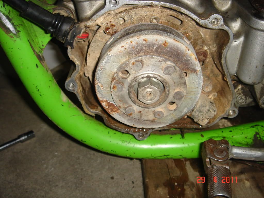

    motor removed.
    Photobucket
    and water runs out of the magneto cover....
    Photobucket
    nice...NOT.. if this was a road bike it would not be going... I'm rather impressed how these dirt bikes work. Being a dirt bike newbee (6 rides and 3month ownership) its amazing that it still went.. and well. Oh would not idle which made riding it hard.. had to keep reving it.
    Photobucket
    HELL if this was my road bike... let alone my RG500...(image... twin crank , square four 500 two stroke motor..... cost to rebuild 5k avg them cranks are moon beams)
    Anyway motor ready for surgery...

    Did a little more pulling apart tonight... main aim was to have the frame and swingarm ready to go to the powder coaters tomorrow.
    Everything was going fine until it came to removing the collapsed swing arm bearings... the swingarm bolt had started working its way through the side of the bearing shell.... and there are two bearings on each side and both on one side were rooted. there is nothing to hit them out with and they are in there very tight.
    Time to start up the arc welder and put some weld on the inner shell and shrink the shell and give me somthing to hit...
    Photobucket
    Photobucket
    Photobucket
    removed, if these had been left much longer it would have been very bad for the swingarm so from that point of view its all good.
