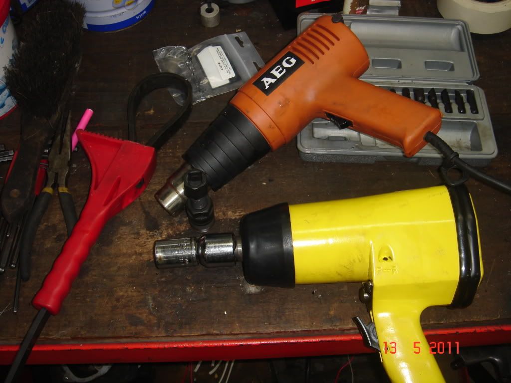

    Being a frinday and all... time for a beer...mmm what are my options...?
    Go inside the house where the wife is waiting for be to paint the kitchen roof which I promest to do and its half done so there is shit everywhere... or open beer and go to the shed...hmmmm ... love to just ge the fly wheel off.
    Give me 30min ... grab 2 beers and off I run... some Neil Yonng on the 165rms garage stereo and I'm in to the flywheel removal.
    First attempt BAD... then get my no fuck tools...!
    Photobucket
    First the red handled strap... no this is very cool... holds clutches.. flywheels etc.. this is the second one ive had and each has taken a betting... seriosly good.. and cheep.... rating 10
    flywheel puller... well its a flywheel puller.. $20 + $5 freight from Barries Point Rd.. tyres place... Cycle treads... to lazy to pick it up..$5 ok. I've rooted one of these before on an other motor because i did not scew it in enough and the pullers thread stripped...shit. Why crao in the thread I thought I had... never again and the thead on this puppy was bad... CRC.. yep love the shit and a tooth brush... screw it in... and.. rating... 7 ( it did not strip) often make my own but $20 bucks..hay.
    Impact gun... a must. Saves so many bolts and shit from being stripped.. ... hmm I like strippers.. Oh back to impact driver yes very cool. Paid good money for a mid range job 20 years ago and it finaly dies.. plastic trigger dies... other wsie mint.. 1/2 inch job. Went for about 6months with no rattle gun.. even borrowed onr for a job... dam its a must have.. bunnings $130 odd for 1/2 inch... found a chinese 3/4inch mother for $99.rating 10 for must have and 500 man points... after all who owns one of these?
    Heat Gun... Gas is better or butain tourch... but i dont have one of those... .. so heat gun.. very good. Best way to assemble a motor heat and cool..!

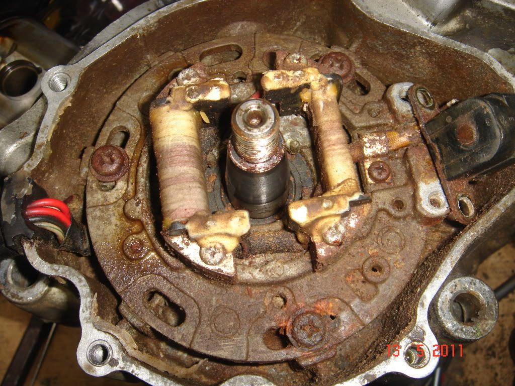

    So the story..
    Heat flywheel with heat gun, fly wheel puller, and 3/4 inch rattle gun and after 30min and soaking in CRC it came un done... all good.

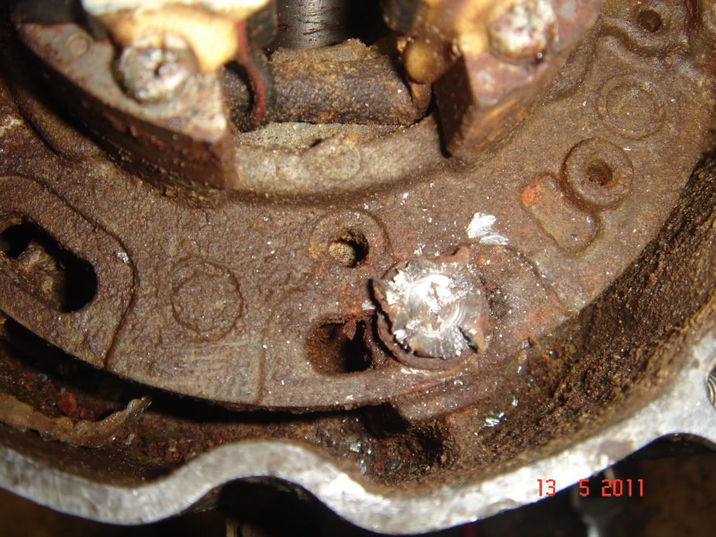

    next whats under the fly wheel must come out..
    Could not undo one screw... chissel on all and only one did not come un done...had to drill the head of the screw off.

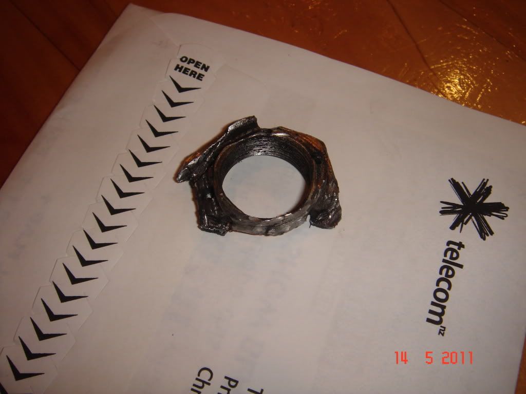

    Then the clutch nut... WTF... I gave it every thing I had with out rooting it... Im talking 3/4inch impact gun... going hard. naaaa nothing.. WTF
    And again WTF.. is this looks like its crimmped on
    Photobucket
    How am I going to get this off... dremal.. grinder i am thinking... Can you belive this thing even went..? shows what a betting a MX motor can take and still run.

    its official.... I hate this motor and it hates me...Now with that sorted I descided to start hitting it with a hammer and it felt good.
    Yep you might have guessed... that dam clutch nut would not come off.... I tried everything... bastards might as well have weld it on.
    I tried all my trickes... heat, impact gun but no go... so I ground it with a dremal, I drilled it with a drill... I smacked it with a chisel... yep it was pissing me off. using these black smith methods had me worried I would root the thread of the shaft and I was farily sure there would have to be a mark... and this is how the nut looked after some cosmetic surgery.'
    Photobucket
    best bit was not a mark on the shaft or thread... luck I say..!
    Even with this it ran... looks OK in side and little waer on the clutch hub.

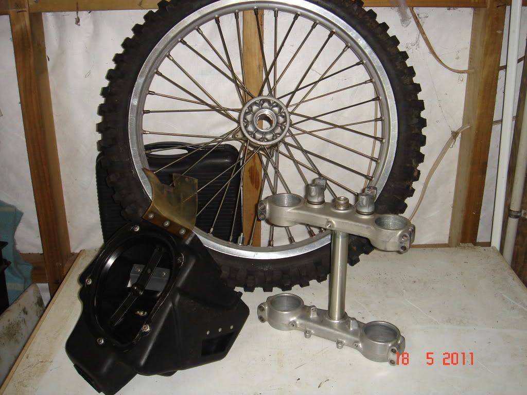

    Not much to report....
    Been cleaning stuff... and all the bolts are getting plated so they should be nice and new looking...
    Had to drill out a broken bolt from the front rim which dies removing the disc... all done and no damge...
    Photobucket
    Man that airbox was dirty... full of sticky crap.... rubber airbox flap is split so tried gluing it, its not on the air box at the mo..... hope to get a secondhand one.

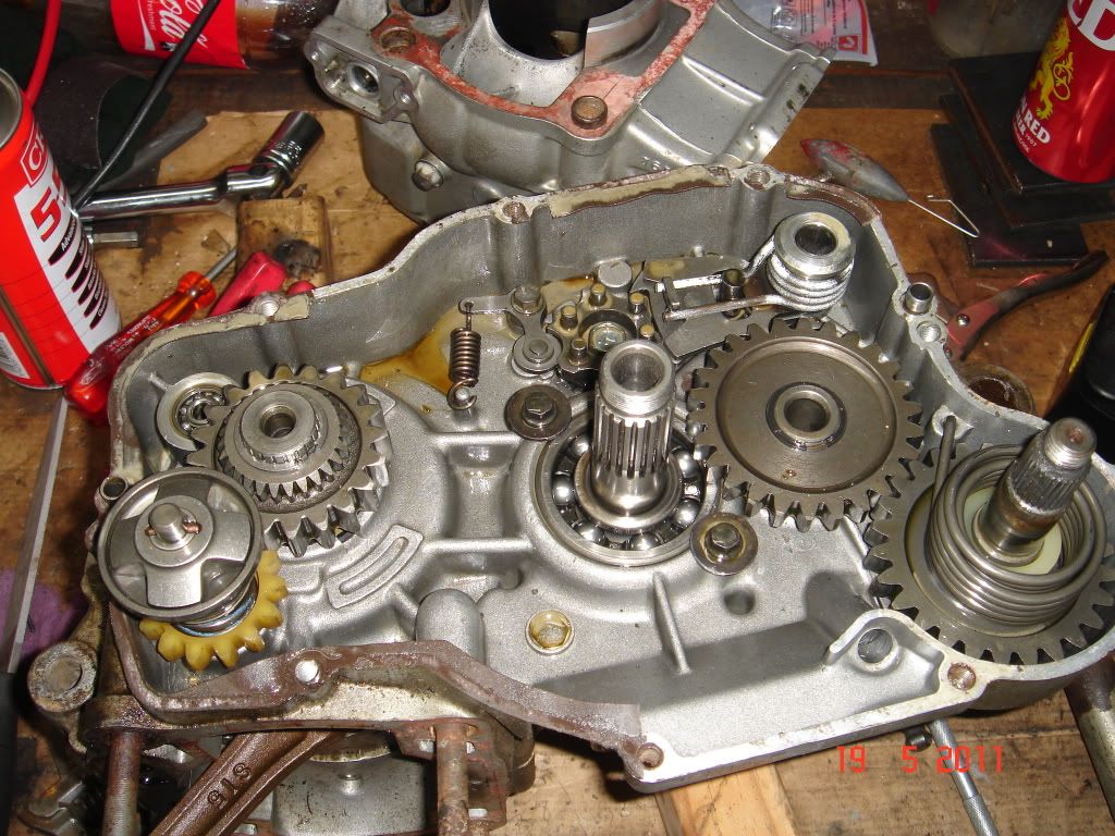

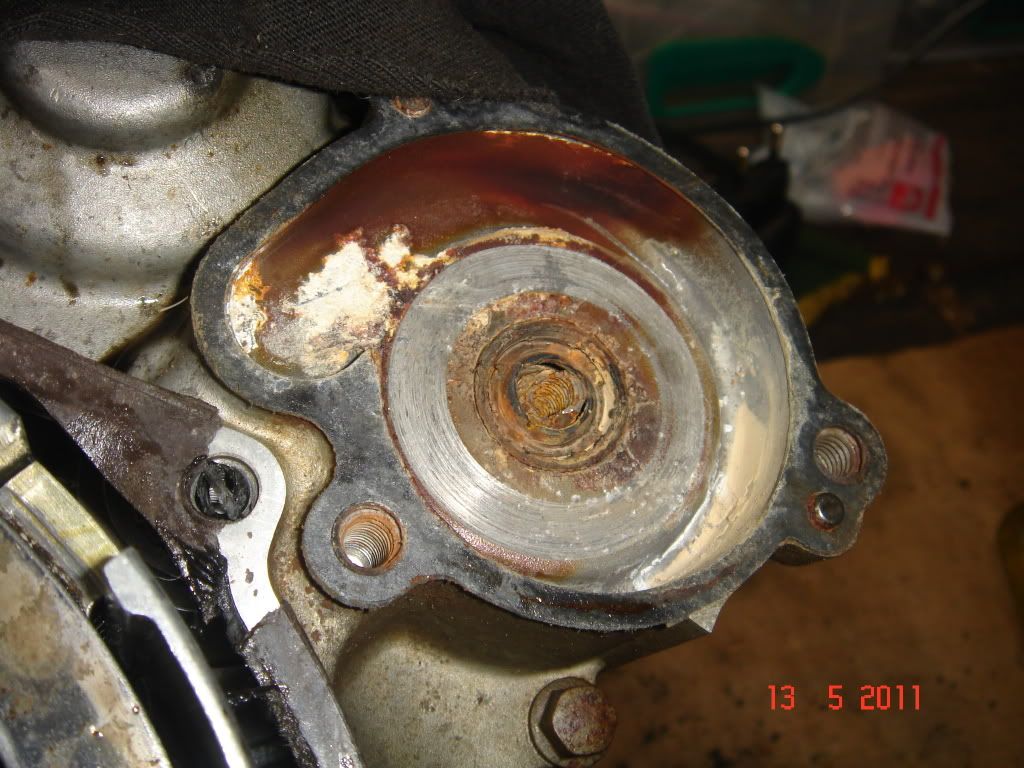

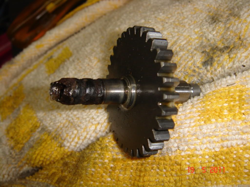

    Enigne is comming apart... slowly.
    WTF
    Photobucket
    Yep one water pump shaft.... = water in crankcase.
    My guess is these crank cases have never been apart... 19years. Why do i say this... the big book of everything... The NET ... many posts tlak about getting the clutch hub off.... super tight... the longer they are on the worse it is to get off... (ha... the price for getting old... the harder it is to get off..) LOL..
    Next the inside of the crank cases is un- touched.. no dents.. rounded bolts screw driver marks etc.. white paint on parts showing that it not been apart. So I like that..!
