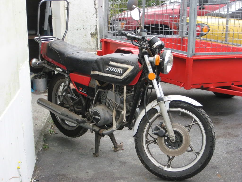

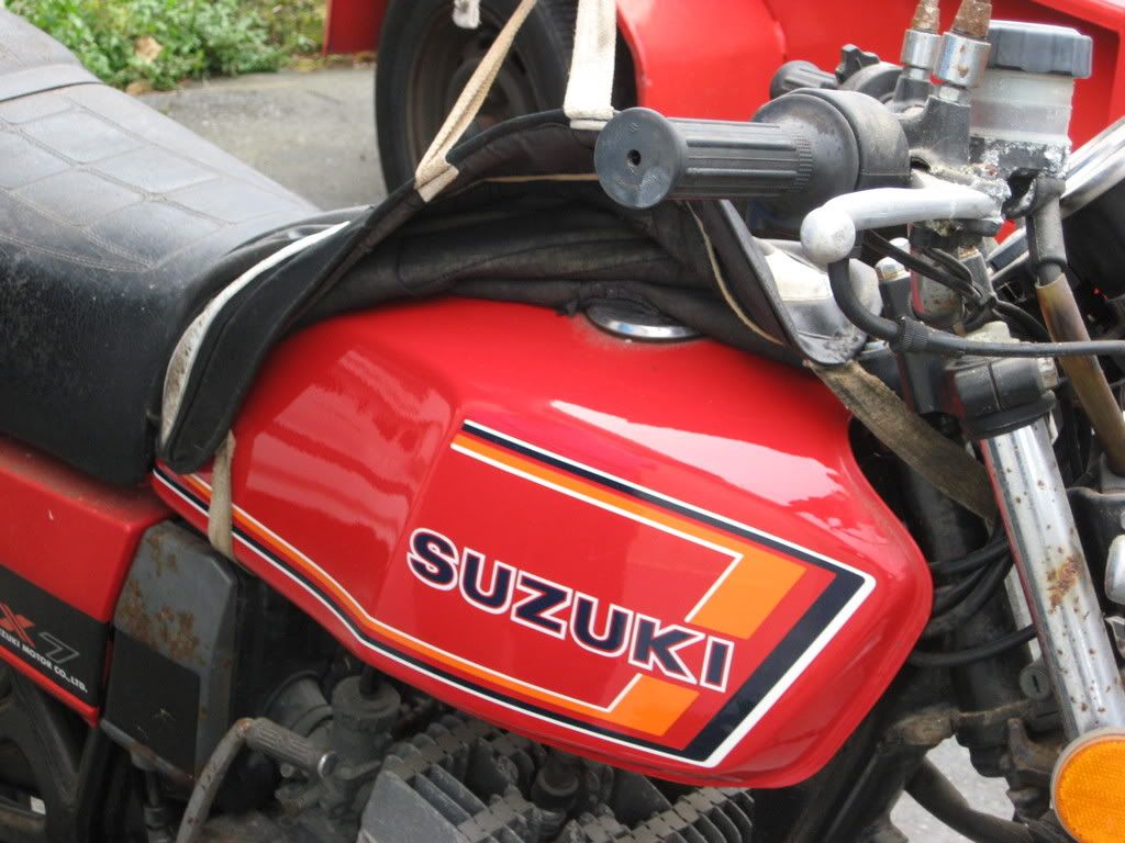

    Hi all.
    '79 Suzuki X7. 16 thou on the clock. Last ridden c. '92. One owner (my dad).
    Want to fix for sentimental reasons, but can't afford the earth. Will ride for short trips on quiet sunny Otago days.
    Can anyone recommend a shop, or someone knowledgeable about these bikes, in Dunedin? What usually needs doing? What it's likely to sting me?
    Only reason he stopped riding it was due to illness.
    Cross fingers that pics are allowed for newcomers:

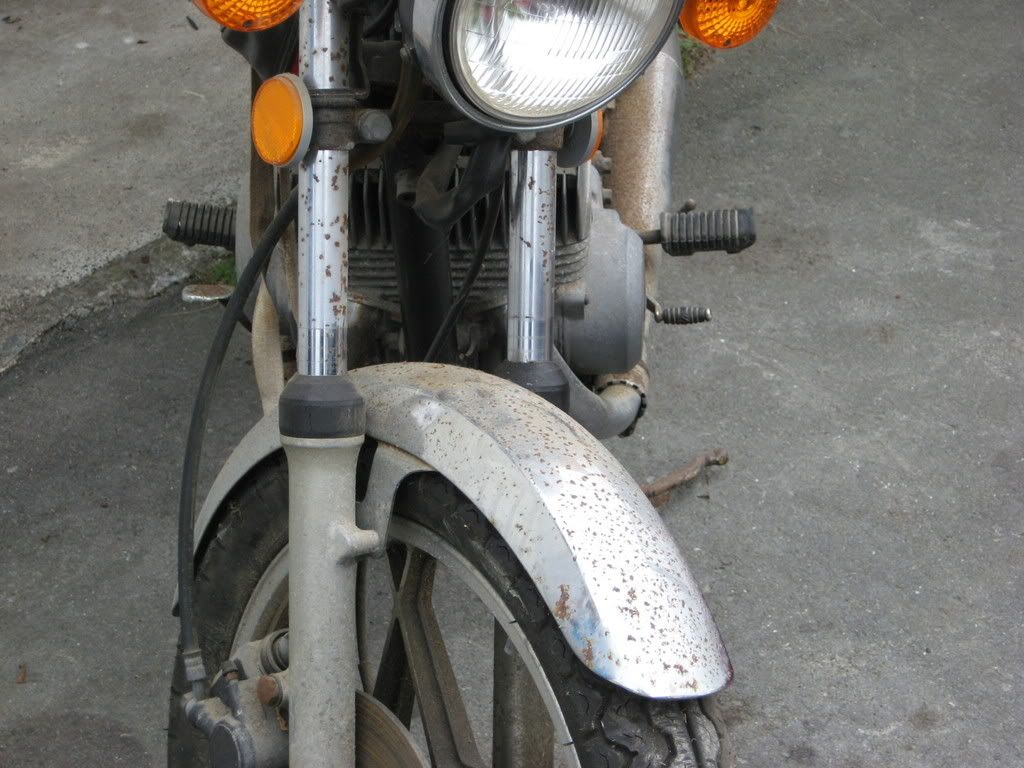

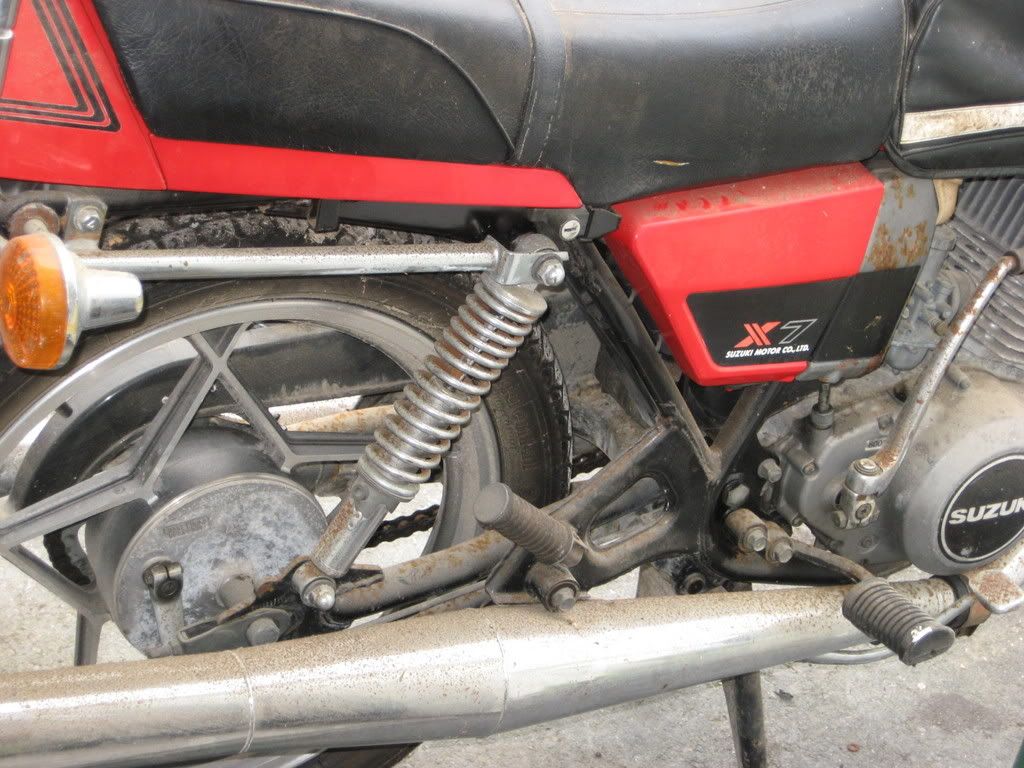

    Hmm, straight away I can see you'll be needing a fork rebuild and new seals...

    Sorry to be the bearer of bad news but if you take that to a bike shop expecting a full rebuild its going to cost a LOT of dosh. Probably far more than its worth to be brutally honest. If I was a workshop manager and you brought it in I'd send you away because goodness knows what issues you would find and there is no way you would be pleased with the outcome...
    Thats the reality. The good news is that basically - its in great shape for its age and these are reasonably simple bikes so the best option is for you to rebuild it yourself. I doesnt need to be a super expensive restoration BUT the basics need a lot of fettling and sorting out... ie TIME....
    Plenty of folks here can help if you get stuck...
    Whatever you do - dont bung it back into storage for sentimental reasons as it will just corrode into a useless lump.

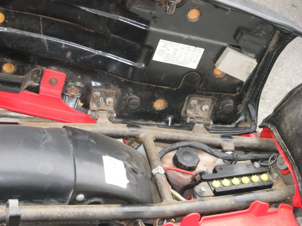

    I am fairly mechanically minded when it comes to cars. Never worked on a bike but could give it a go if it's not too hard. Haven't got a clue when it comes to carbs.
    I guess I'm most worried about
    1. If the frame is shot
    2. If parts are impossible to obtain, or cost the earth.
    Guess I will try to get it going, what's the best method? replace the 2stroke oil, pour a thimbleful down the bore, replace battery and cross fingers?

    Looks like a neat wee project, I want it. Few bits will need rechroming, others a good dollop of autosol and elbow grease, paint work looks quite good too so thats the easy part. Engine, suspension (front forks will need fixing up but try polishing and see how much of that corrosion goes away , might get away with back shocks) electrics would pay to check just in case someones been hungry. Try lubing cables connections etc to free everything up, probably will need clutch cable. Does it turn over? Change oil, take out sparkplugs (you'll need new ones) put some oil down into cylinders turn it over a few times to coat everything. New battery see if you've got electrics, who knows new plugs and it might start. Dont forget the 2 stroke oil if you do try to start it find someone who can do a proper ratio of premixing the petrol and oil put that in your petrol tank as the bikes 2 sroke oil pump will probly not work and will need a fettle likewise the clutch, brakes etc. Anyway thats enough prattling from me thats just what I'd do and as I'm not an restoration expert / mechanic I'm sure theres lots I've missed but its a start. Just take your time and have fun. Oh you'll probably find the seals in the engine will need replacing and carbs will need clean etc .

    Get hold of me if you want mate, one of the boys here has a couple of X7's and he may well have some spare parts you'll be neeing. Like fork tubes...but it's a very nice original starting point, and done well you'll have a neat wee bike. They're the first road bike I learnt to wheelie properly on!!
