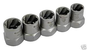

    can't go past a snap-on easyout, but the OP now has a problem with an easyout snapped off inside the bolt. it ain't gonna be an easy fix!
    Quote Originally Posted by marty View Post
    Do you mean these Marty?
    Or the Blue Point ones?

    nope - these ones: only A$637 a set. I've got one
    lol thats a nice looking set - but on my $2500 bike i'll prob settle for drilling them out completly first
