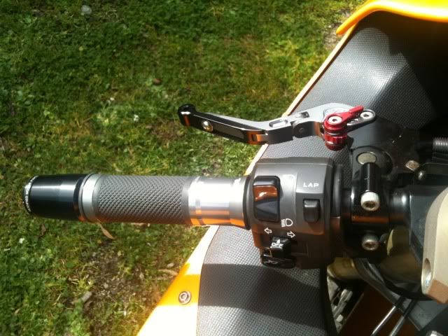

Name:	2011-08-31 13_03_32.jpg
ID:	245944Click image for larger version.
Name:	2011-08-31 13_03_21.jpg
    THEY ARRIVED!!!
    A small box was awaiting me when I got home for lunch. Fitted them straight away. They look and feel friggin awsim. YAY!!!!!
    I've spent my money on bikes, booze and babes. The rest I've wasted....

    Hey what's with those half metal grips? Is it purely bling, or is there actually a half decent reason for having them? I'd imagine losing grip when wet or whatever. Each to their own of course, I was just wondering.
    With those I believe you can adjust the length of the lever. from full length down to a shortie.

    Quote Originally Posted by 5150 View Post
    Yeah I can see that. It was the grips I was asking about. Cheers.
