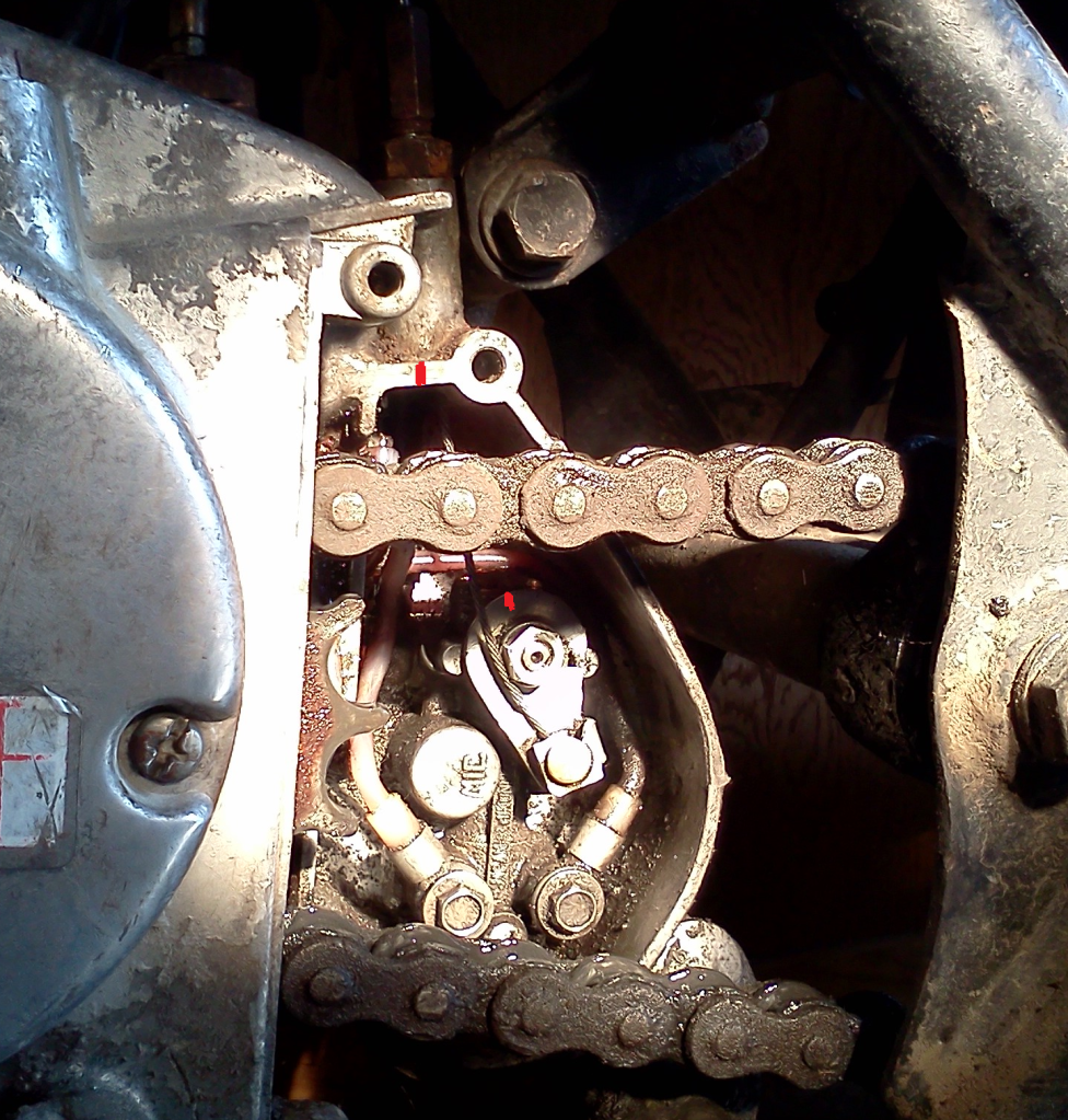

    I cleaned the pump arm and casing with a petrol soaked rag, and underneath all the crap there are 2 markings, 1 on the pump arm, and the other on the casing. However, there is no way those 2 markings will line up. I have tried pushing the pump arm by hand all the way from the closed to the fully open position and they don't come anywhere near to lining up. There is no way they can even physically line up without smashing the pump apart.

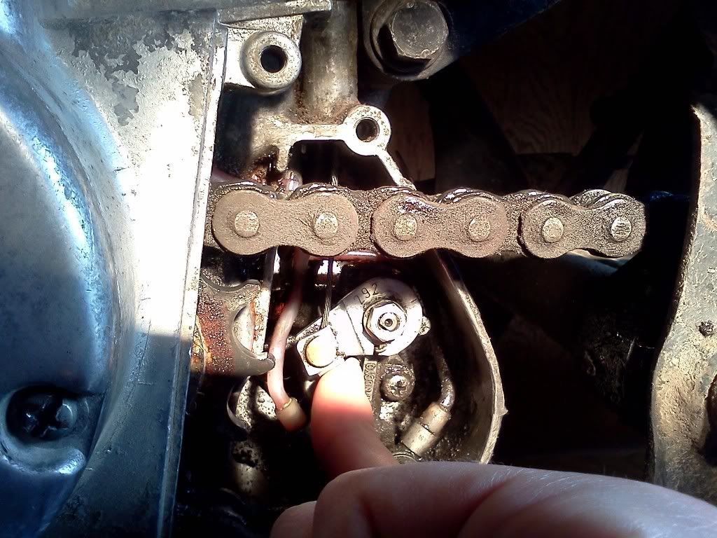

    I've already had a look at that link and there is no way that I can see how those markings are going to line up. I've included the links to 2 of the pics I've taken of the pump, the red markings are there to show where the markings are on the pump arm and housing to make them more clear, and was taken with a closed throttle. The pic where part of my hand is visible is where I moved the pump arm to show what happens when the throttle opens. I won't embed the pics here as the mods will get shitty due to them being oversized.
    http://i305.photobucket.com/albums/n...5/Untitled.png
    http://i305.photobucket.com/albums/n...185/IMG081.jpg

    Quote Originally Posted by SMOKEU View Post
    Ok.. Theres something NOT right there...........
    Look at the first pic... theres no way the cable should be pulling straight
    though length wise on the arm... the arm is in the wrong postion on the shaft.
    I would guess the arm needs to be rotated near 90* then reinstaled on the shaft..
    Something needs to rotate... wheather its the arm or pump internals ?
    Dose the twist grip start of hard then suddenly get easy ?
    What year is the TS... looks to be a older one ?
    Pete

    Quote Originally Posted by pete-blen View Post
    Ok..
    It's a 1973 model. I still don't see how those markings are meant to line up, even if the pump arm is rotated as much as possible. Just above the red mark on the pump casing the cable goes in and when that cable is pulled, the arm moves in a clockwise direction.

    In the pic below..
    Take note of were the rest point of the arm is with a closed throttle
    in relationship to the pump body...
    Then have a look were yours is... Your arm is about 30* retarded..
    I feel the arm has to come of the pump shaft and be re-postioned..
    I can only point out the possable issue... You are the one who is there...
    you are the one that has to figger out how to sort it...

    That pumps incorrectly assembled. Check the the drive flat hasn't logged itself out. The align the marks info is correct I've done it hundreds of times on many Suzuki smokers, 50cc to 750cc.
