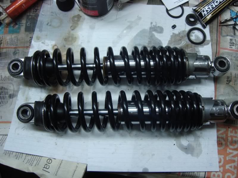

    I recently sold my Thruxton but kept the Ikon shocks as they are way better than the Triumph ones.....in fact I like them so much I got a set for my Commando off TM. I fitted them but the ride was horrible, due to the springs being for a big fat Hinckley Bonnie.
    I contacted Ikon and they sent me some 215 springs for them and wow....much nicer. Static sag of about 25/30 mm and able to adjust the rebound.
    I built up an R90 track bike last year and borrowed the Commondo Ikons, they proved to be very good on the track and for some reason I am not even aware of the jacking effect of the shaft.
    Recently bought a BMW r65 and its shocks were tired.....but a new set if Ikons were nearly $600 so picked up a set of Konis on Ebay to play with.
    Pulled them apart using the Workmate, make sure you wear eye protection.
    http://i129.photobucket.com/albums/p...Compressor.jpg
    Made 'special too" to take them apart
    Drained out the 35 years of splooge.
    Emailed Ikon and got a new seal kit and some 215 springs.
    Assembled them with 85mls of 10 weight fork oil.
    Put the new springs on.
    Put them back on the R65.
    Initial impression is a far more compliant ride, only set on position 1 and click 1 so can experiment with them.
    So if you have an old set of Konis and the shafts are not pitted, you can get the seals and springs and give them a new lease of life.
    Ok they might be old tech but they work ok and are rebuildable.
    I suspect a lot of them are over sprung and the oil is stuffed.
    These are the 76 series 'dial a ride' models.
    I'm going to put the longer 14" ones on the R90 track bike for the summer, sharpen the steering and raise the rear slightly.

    The dial operates a rod that opens and closes regulating the flow of fluid thru on rebound.
    I flogged off all my old konis a few years ago as I found them heavily spung.....
    As mentioned I had a Triumph Thruxton and the stock dampers are over sprung and under damped, the Ikons I got to suit my weigh were a huge step up. I'm not saying they are the best of anything but with correctly chosen springs and new modern fork oil they are not bad on the old twin shockers.
    The oil in your GS ones....has it ever been changed?
    You can get an idea on the springs using a drill press and bathroom scales..... put the shock one the scales, zero it, and measure the travel over 1" and compare to Ikon chart.
    I now own 4 sets of them and they will do as far as I'm concerned on the old 50 HP machines.
    You can probably get a racetech emulator kit for the front end too, I did my BMW and I'm happy with it.
    All that a nice set of BT45's make for a pretty good handling 70's bike.
