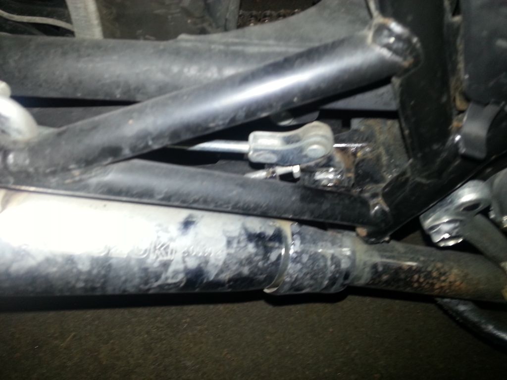

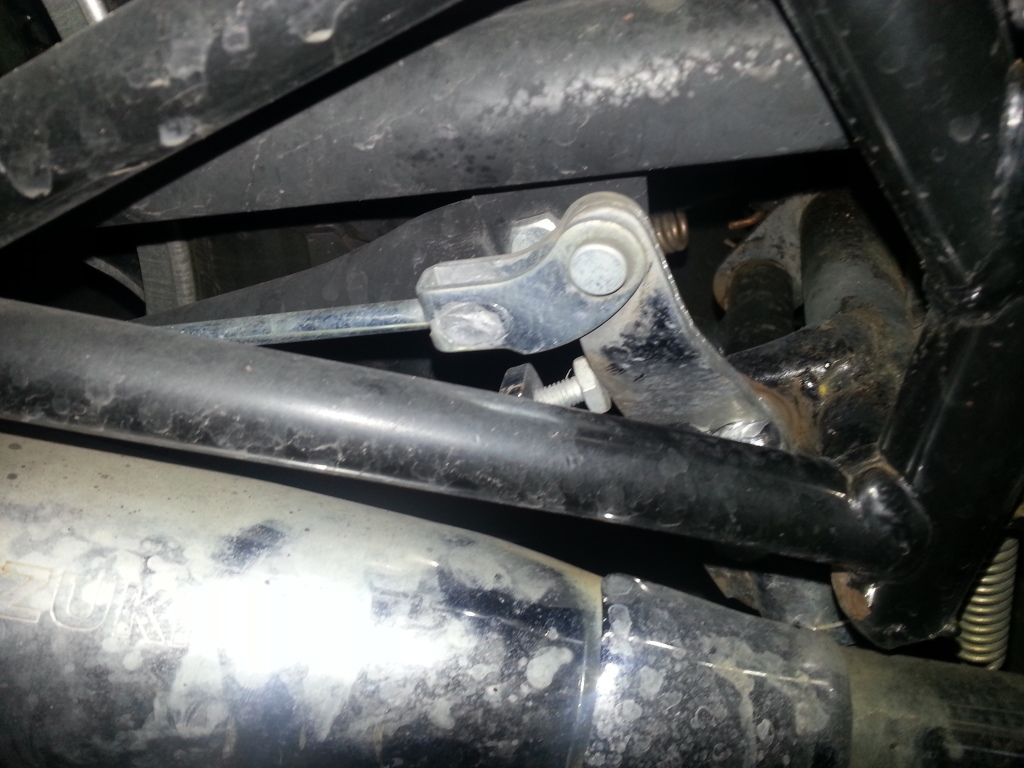

    10th May 2012 - 12:58
    2004 Suzuki GN125
    308
    Sorry for the HUUUUUGE photos. Not sure how to make smaller.
    This little bolt lost it's nut. The vibration prob pushed the bolt upwards, forcing the brake lever to be pushed on all the time.
    As for why I have no bolt? I don't know. Only thing I can think of is that when it got serviced just before I got it the guys forgot to put the nut back on.
    Either way, if I screw the bolt in a bit it's all good. So I'll just go buy a locking nut on Saturday.
    Anyone know off the top of their head what size nut I'll need?
    Note to self = Clean bike this weekend.
    15th February 2005 - 15:34
    Katanasaurus Rex
    The Gates of Delirium
    9,022
    6 x 1.
    Dime a dozen.
    22nd March 2007 - 10:20
    2015 HD Street 500
    Blenheim
    2,178
    Quote Originally Posted by Lozza2442 View Post
    M6....
    Try and get a stainless steel or a zinc coaled one, as a mild steel one will rust and seize.
