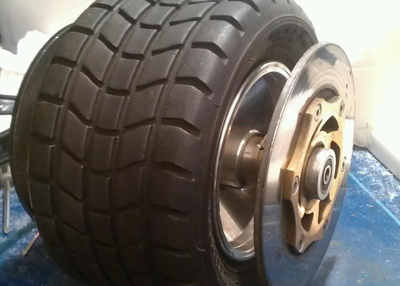

    Hi Carl, re the kart rim option the front ends need some thought, a rear kart rim is fixed to the axle which spins in bearings but you need to go the opposite way and have the rim run on bearings and fix the axle. I couldn't make my own hub up and had to get Darren Morgan to fabricate one (I'm talking Henk and Ricks rig here) which holds the bearings and also has a flanged end to take a disc for the brakes. My blue rig runs the same set up. On Henk and Ricks rig I also placed the axle in large Rose joints to try and take out some of the misalignment in the forks. It sounds simple but it isn't something I could do with the required accuracy with the tools I had. The rig Chris got had the same sort of set up but was Only able to run an odd ball tire that would fit the rim is made up, it never had much stick, I think Chris,before he left, finally sorted a decent front rim/tire combo.
    Check out those rigs to get the idea. I also tried to make up a leading link front end but due to the low axle height I was struggling to get the angles to work without fouling on my front rail, I doubt it would be worth the hassle to be honest, throw on a MG yellow and you wont get the front to lose traction to easily.
    If you can make it to the track this weekend take mine for a run and see how it goes.
    Front disc hub off a gearbox Kart has all that although you'd possibly need an axle to suit

    Hey Pumba have to agree best way to go for bucket sidecar is a simple frame and kart running gear, the only down side and reason i on sold the one i had to Henk and Rick is being a big guy my weight would upset the handling which doesn't seem to be an issuse with my current one. Although it doesn't seem to like doing more than a couple of laps.
    Here's some tips for you if you go with go-kart running gear, use a 30mm or 50mm medium axle.
    Run split rear sprockets which will make it easier if you want to change the gearing.
    Treat it like a go-kart not a bike with reguards to gearing, i've changed the gearing on the one Henk and Rick own and Brentons one. Originally one of them had a 40 tooth rear sprocket and i think now their both around 24 or 27 tooth rear.

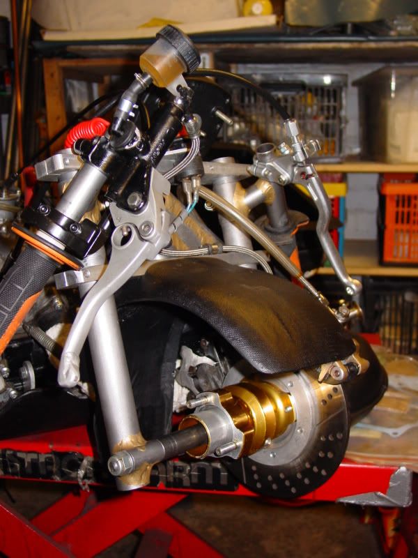

    My front axle is a piece of 40mm ally bar, bored out for bearing spacer tube, bearing recess in each end and 8mm woodruff keyway all the way down. I can slide brake disc carriers and wheel hubs up and down and nip up where needed.
    You can also get wheel hubs with bearings in that carry brake disc carriers. And brake disc carriers with bearings that carry wheel hubs so thats two more methods to consider.
