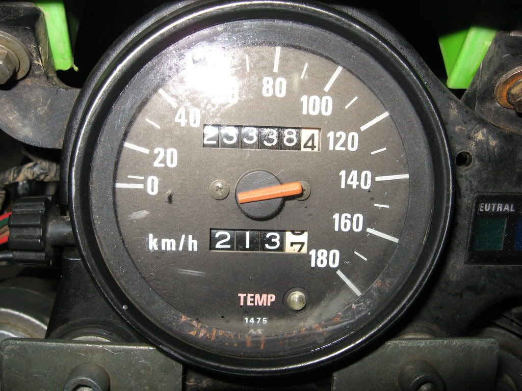

    Thanks for the replys,
    The needle isn't broken in the sense it doesn't give a reading.
    It is literally snapped.
    It looks like this:
    It still functions accurately.

    I had a similar problem in a Nissan van I owned and fixed it by glueing a piece of white card bent in a vee shape onto the existing needle stub.

    Is the broken bit in there? You could easy get this fixed at in instrument repairer. Good op to paint the casing at the same time.

    Quote Originally Posted by Petah View Post
    [IMG]
    ... i got a fuel gauge looks a bit like that.
    welcome to KB.
    If you can either get the glass face off ... or get at the dial face, you could glue a new pointer on top of the broken one.
    Speedo's must work to get a WoF ... nothing in legislation requires them to be accurate.
    If you can convince the WoF tester that you can tell what speed you are going ... he may pass it.
    Correct the speedo must work to pass a wof, as for accuracy ( here's the kicker ) if the wof agent does not think its accurate
    he can require you to get a calibration test done. ( so don't glue a needle on top of the old one as it will be well out. )
    options are send it off to be repaired or scource a replacement speedo and install it but you will have to take the old one
    with you to the wof to get the milage corrected. ( not like your on RUC but hey )
    third option replace your speedo with a aftermarket unit ( not some push bike unit ) as the speedo has to record milage as well as speed.

    Ive passed a warrent with a pushbike unit as mileage recording function of the dial, as is this case, was working. Or maybe the tester was feeling sorry for me

    Easy fix when you dont live too far from .............
    Speedo Shop
    Contact: 07 847 3343
    3 Empire St Hamilton 3204

    "John at the Speedo Shop has advised me that he has no parts to fix your speedo."
    All good though Ill find a way.
