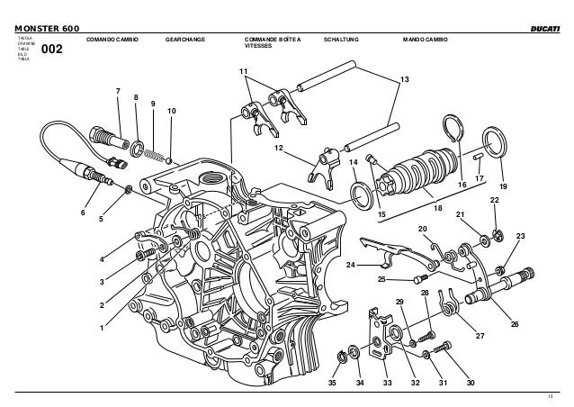

    I know the picture is of a 600 Monster gear selector but the Diavel arrangement is almost identical.
    My guess would be a broken spring (number 20).

    Then it's possible that the arm (part #24) has jammed due to the spring being broken.

    if the lever is stiff its the shift fork (24) stuck on one on the pins(17) on the shift drum (18). If the lever is loose it means the timing gear has chewed the spring (20) and broken it.
    theres a repair kit availiable with updated bolts (28,30), and a meatl plate to apply the pressure over more area to stop the whole mechanism moving and causing this problem.
    I have the part number around here somewhere but it is easy to google. its around $50 I think.
    Its piss easy to fix, about an hour. If you are tight you don't even have to drain the oil.
    Close.
    It's the spring (27) that stops the gear lever flopping around like a cock in a sock.
    no, what happens is when the whole mechanism moves down (or forward), the round bit on spring 20 which goes on the pin on 26 touches the timing gear (theres only 2mm clearance on a down shift when adjusted properly) and theres no tension on the shift fork 24.
    trust me, I had to ride back form okororie in 5th gear the other week.
    Don't make me come over there and beat you off.
    It's the spring (27) that holds the gear lever firm and provides the pressure to return it to it's the central position.

    mine used to get stuck on every ride at least once, I used to be able to kick it and free it up. I had the parts all ready to go, but I was always going to "do it next time it happened".
    then the spring went
    correct numb nuts, but spring 20 puts tension on the fork so it actually engages with the pins on the drum, instead of just rubbing them up.
    feel free to come over I've still got pieces of broken spring you can molest.
