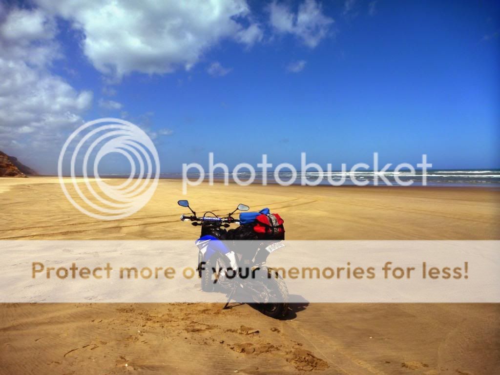

    2016 model
    Just a few farkles - engine is still standard thought I’d wait till the two year warranty is up later this year.

    Quote Originally Posted by pomgolian View Post
    That is a fantastic photo, is that on the east coast? Full exhaust and fuel programmer transforms the bike, really lets it breath easier.
