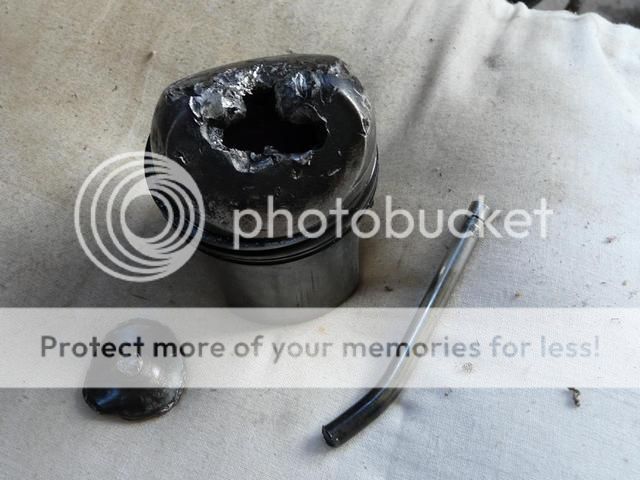

    I dropped a valve on my Velo and am in need of an exhaust and inlet valve for a MAC. Standard valves I believe.
    Like an old wise fisherman once told me , fish your feet before before heading off in a boat. Maybe someone knows of something around here,before I start on the extensive net search?

    If you can piece together some specs from the wreckage: stem dia, head dia. rough overall length, I'll see what i can adapt.
    Bring the damaged piston to the pre 82 cup meeting too please.

    Will do. The tough old bird despite the valve bouncing around and smashing shit out of the piston and banging the head a bit is relatively cool. I have the stem and head in two bits.
    This is where I'm supposed to say "call that damage ? Now this is damage" and post a pic which would embarass us both...so I won't.

    I'll endorse this though I think you may have spoken to him at Levels anyway. It gets you plumbed in to the NI velo clique who will have the right ideas on what to use. Do not ever use original parts in it....by the time they were making them their machinery was worn out. Modern parts are better made from better materials.

    ...all sussed now... thanks to Grumph, swarfie, Sidecar Bob, and me, deciding which way I would go...now I've gone...thanks...anyone have a 5TA (68.5 mm) piston to sell me?...so I don't have to leave my chair...

    ...got caught in a large set of viral road cones that hindered my progress towards his area, then got spat out and ended going somewhere completely elsewhere...it was 30+ so I squawked at other drivers and went to the Tai Tap for a beer...will try another approach road soon...6 weeks for CHS to do the valves, head, guides etc...that timeline suits my empty pocket...
