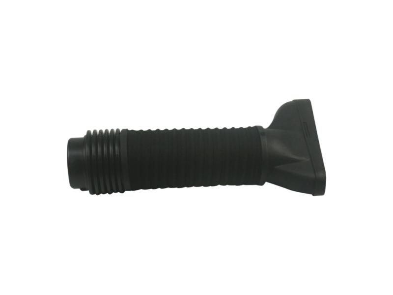

    I have purchased some big bore air tubes designed for use with a Mercedes-Benz intake system.
    I am planning to side feed these directly to a set of CFmoto 250 K and N type filters. with the center intake feeding the sr4 air filter from above
