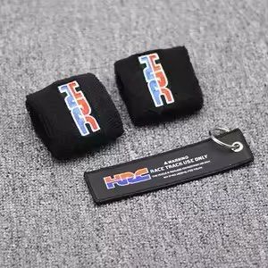

    I think you will find they also wore sweat bands on wrists to avoid I guess sweaty hands losing grip on the racket. Not sure if both wrists, they only use one racket at a time I believe but I think it should be two and two balls. Gotta be something to make the game interesting.
    Maybe solar heating of the reservoirs was suspected in hot countries? One person did it, then. . .
    Quote Originally Posted by SaferRides View Post
    According to Ducati:
    Widely used in the Racing sector, it has been designed to preserve the bodywork from accidental leakage of fluid, as well as to protect the fluid against UV rays that may cause it to deteriorate. It improves the aesthetics of the standard reservoir.
    They are called socks BTW.
    Sent from my SM-S938B using Tapatalk
    Might have to go look on aliexpress
    I'm about to do the same. They don't seem to last long.

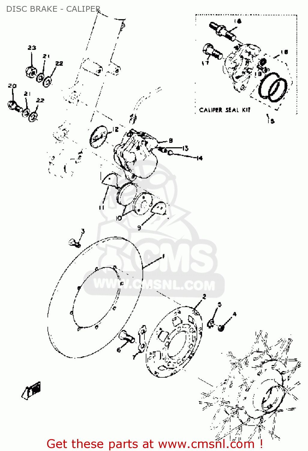

  4. #139
    12,352
    Hours of thinking about it, ends in just a few minutes of doing it....
    I still need to tidy it up a little bit with a file and some scotch-bright.
    I think I'm going to have to make the double thread stud as the original piece is NLA.
    A shoulder bolt would work and is KISS.
    Attachment 356005Attachment 356004
    For Providence, here is the Ducati Roche road in 1989 WSB round at Aussie
    note the rear caliper location.
    Attachment 356006
    okay
    Part 42 is NLA but i found a substitute right under my nose.
Name:	Screenshot 2025-04-05 5.13.33 PM.png
    its from Yamaha RD floating caliper part 18.
    https://images.cmsnl.com/img/partsli...43e-3_be76.gif
    Also NLA but i have a couple in the shed.
    i know it's safe to use in a brake as its built to use er in a brake....
    https://www.cmsnl.com/yamaha-rd350-1...-2_3062582201/
    EDit wellf-ed up there the yamaha part is 10mmx8mm i needed 2x6mm or 6mmx8mm
    I have also figured out how to do the floating caliper that is captive for aster wheel changes i will draw it up later but its pretty simple.
