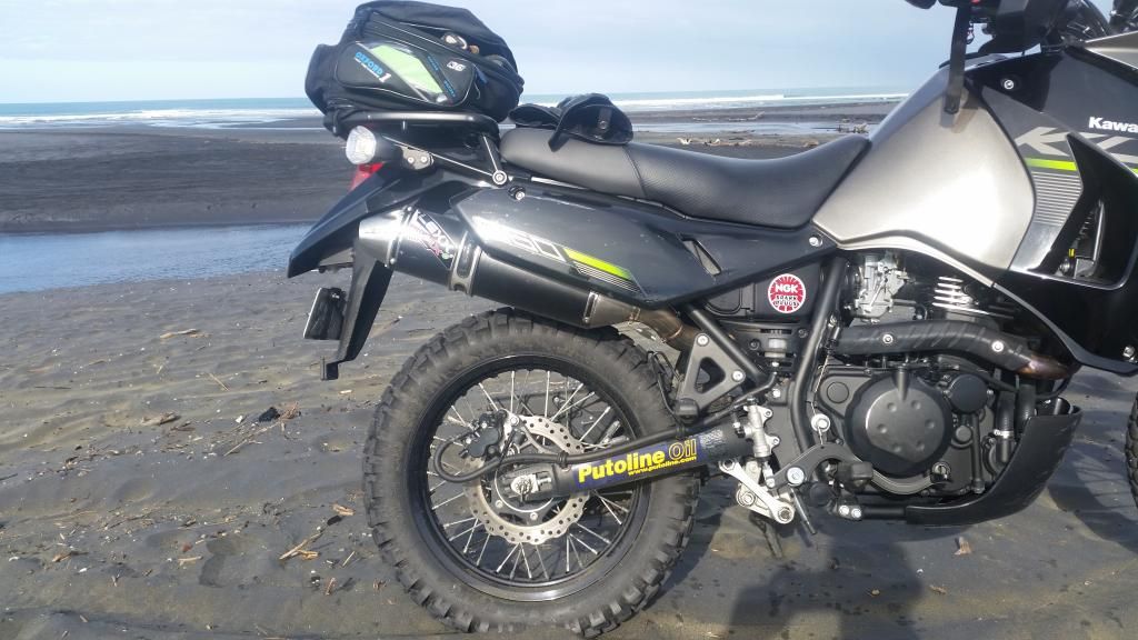

    I second Petes endorsment. They should be worth more.
    Would also recommend trying the 244, just a bit more grip off road and great on, have done 2700k and tread has gone down from 12mm to 9mm (including 1500k road trip so perhaps would wear more in general use) running 33psi except in the sand (20psi)
    Am awaiting a front 244 to arrive to replace the original front so am hoping that will impress as well
