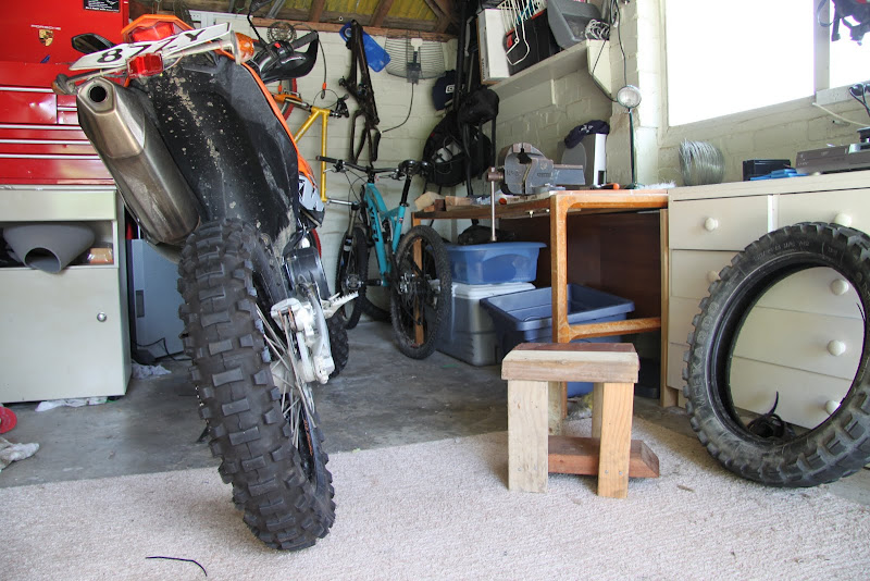

    MT91 fitted and ready, predictions of how many km's I shall get out of this one?
    (and see the other half of my garage is not so messy)
    By far the knobbliest tire I have fitted on the 690, should be good fun, farm tracks/beach here I come. Just hope it survives the tarmac getting there.
