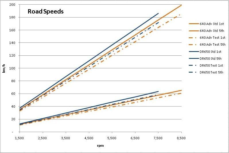

    Roads speeds in the gears
    Orright, here's a chart showing the road speed for 1st & 5th gears, for the bikes as standard (solid line) and as tested (dashed). The colour/style is the same for 1st & 5th, I'm sure you can work out which is which.
    Sprockets
    Tyre
    640 Adv Std16:42140/80-18
    640 Adv Test16:44130/80-18
    DR650 Std15:41120/90-17
    DR650 Test14:41130/80-17
    So the 640 is actually lower geared, but the extra 1000rpm headroom gives it longer legs... eventually. The 640 is pulling an extra 200rpm at 100km/h.

    WW looking at your fancy 5th gear rev/speed chart has raised a question about my 640e.
    I did a "high speed" run on the weekend (just to see what she'd do) and found that at 147km/hr it was pulling about 7000rpm (dash light stardted flashing at me) in top gear with standard 16/42 sprockets. this was its MAX speed with my fairing on which i was a little disapointed about, have you ever "wound-out" your adv or no what its actual top speed is?
    Clearly even without the big fairing and chin on the tank i dont think mine will make it anywhere near the theoretical geared max of 200km/hr.
    KiwiSafariTeam
    GO BRO GO
  12. #1377
    2nd March 2004 - 13:00
    FransAlp 700
    14,484
    Something sounds wrong then.
    I pulled 140kph on CrazyFrog's DRZ on gravel (Northbank Road out Springs way on the Dusty).
    Almost sounds like you were in 4th gear?
    The DR in 4th on the dyno pulls about 140kph at the limiter...

    Quote Originally Posted by topo View Post
    Ummm, if any are reading this, it's baseless bragging, fairy stories or closed roads.
    On the tar I've seen 185 on the speedo and it was still climbing, near 8000rpm but was past the peak. Never topped it out. What's that saying about the rider being the limiting factor? No doubt there is some error there, but at lower speeds its within 5% of the roadside radars. Seeing mid-170s on the tar is no problem at all, it pulls hard up to that.
    Pete and I did a wee comparo on the gravel coming back from the Brass a while ago. The F650 ran out of puff around 155? (he stopped accelerating and then I wound the throttle on) and the 640 was still accelerating at 170, slowly because it had an MT90 A/T spinning up in the gravel.
    The E might have a lower primary ratio - possible given the slightly different target - but not according to a quick google.
    What size rear tyre are you using?
