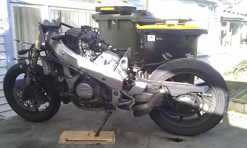

  15. #1770
    18th November 2010 - 22:19
    1994 RVF400R
    118
    Hey Guys.
    Thought i would keep you updated on what im doing to my NC35.
    Needed to keep myself off my bike until my knee fully heals up to allow me to ride comfortably.
    So to take away the temptation, i decided to buy a new full set of Chinese fairings, new exhaust can, levers, and a few other bits and bobs.
    Got a bit bored, so i started taking bits off the bit for a spot of cleaning, and well i kinda got a little carried away.
    That was about 2 days ago, it has now shed a few more parts.
    Half the bike is outside, and the rest is in my room.
    Progress has halted a bit, as i need to get a torx set to remove the ignition barrel from the triple clamp, and i need a hex key larger than 6mm to take off the rearsets.
    This dismantling process has become a little addictive, and i honestly hope that when i do finally put it all back together it starts up first time.
