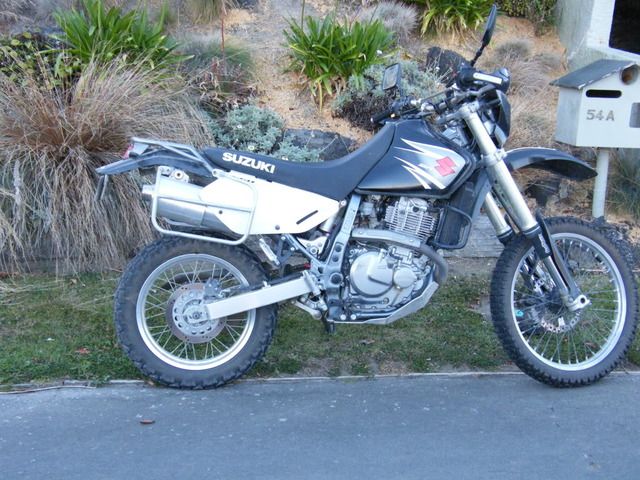

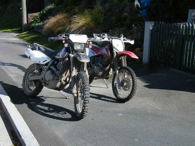

    Forks are 2003 KX250, rear shock is DR body with KTM250 internals, muffler is 2004 GSXR1000 shortened (cat removed), carb is DRZ400E.
    Forks were an easy fit, stock ignition switch wasn`t. Pegs lowered (cut and weld), fatbars, barkbusters, vapour spedo, DR djebal indicators, HID headlight conversion, 2x 10watt LED spot lights, made my own side racks & bash plate and refoamed and reshaped my arse killing seat.
