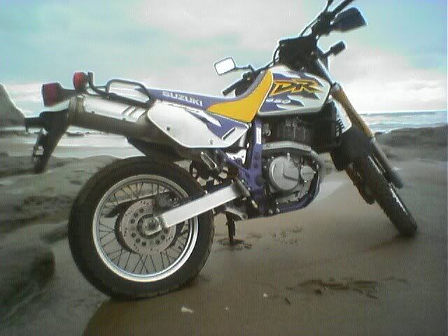

    Sorry to interupt all the valuable correspondance on this thread, but I thought it was about time someone chucked a picture on it for those of us who....well....only look at the pictures
    me trusty old DR...we used to make beautiful music together
    ....wherezz that track go
    Banjo music of course for a yank DR650.
  12. #1437
    16th April 2007 - 20:06
    2,450
    Country Music of course for a yank DR650.
    Yeah, it looks like the left hand drive model.
