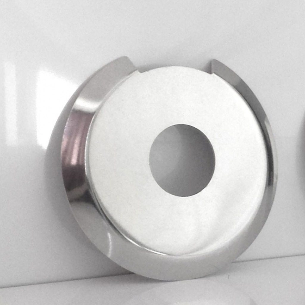

    Bash plates
    If anyone is looking for DR650 & DRZ400 Click image for larger version.
ID:	347658bash plates I’m still making them
    Contact me for all your Suzuki DRZ400 And Dr650 bash plate needs. Made to order
