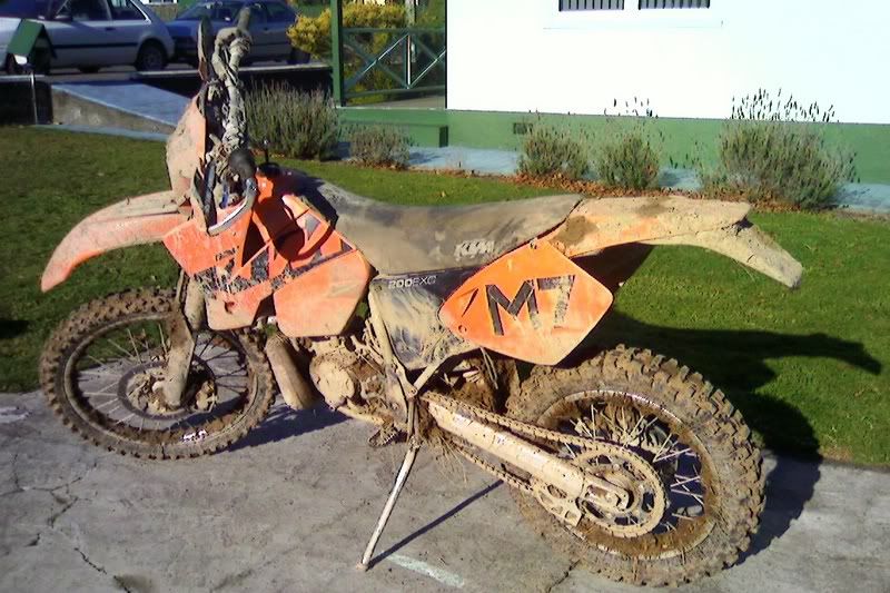

    Like this:
    The only problem is fitting it in your panniers until such time it's needed!

    Like this:
    Yep, that'll work!!!!!!
