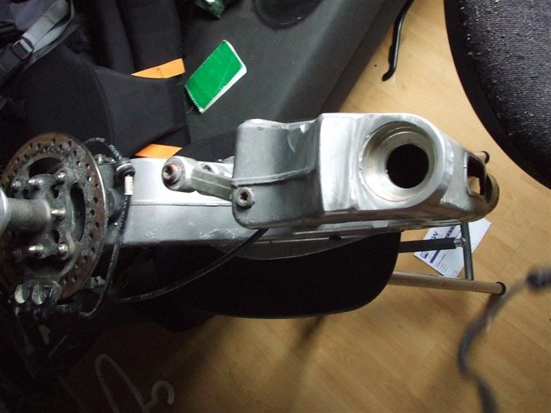

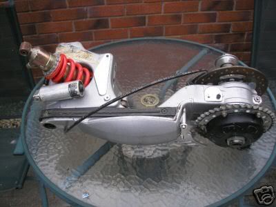

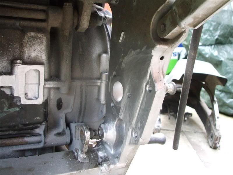

    stage 3 starts with this little bad boy
    a triumph sped triple single sided swing arm,

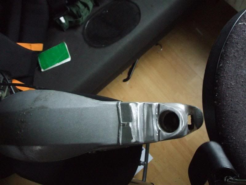

    knowing what i know now i would have gone for a vfr750/800 arm as its alot narrower than the speed triple arm, which reuired me to mill it down and re-inforce it as it was quite thin
    any way pics
    after milling and welding
    the other side
    a bit of a test fit
    16th February 2007 - 08:25
    vf1000,mz500,xz400,kh125,bridgestone60
    new plymouth
    533

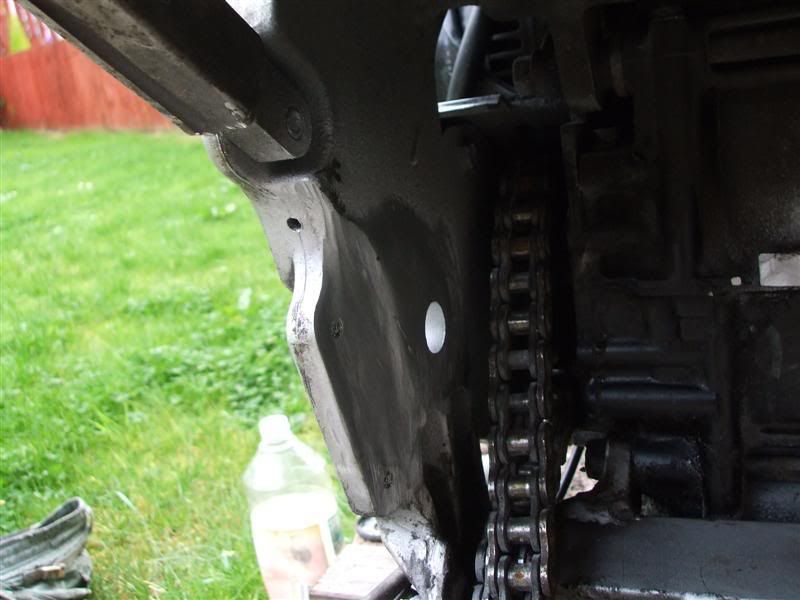

    here is the grinding to get the clearance needed

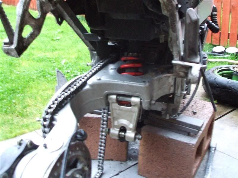

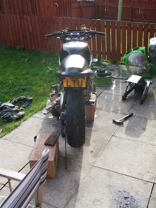

    and here it all on, with bearings to fit the zxr axle, and a good clean up
    from the side
    from the back
    and from the other side
    i have the rear sprocket on now, and am getting custom made dog bones to fit,
    and then she'll almost be done for this stage,
    and if any one says ive ruined a perfect classic race bike, then they can just suck my $%^&

    Nice one... that looks really good

    cheers, it'll be good to be back on the road

    Bro that looks mean!
    I thought where are you going here? With the swing arm, but it looks great and I bet it will wheelie in any gear now.
    Good work.
    I am going to be trying this with an rvf.
    TMF
    new plymouth
    533
    i thought the rvf already had a single sider on them??
    yeah i dare say she'll be a bit odd to start with as the wheel base is about 5-6cm shorter than standard (depending on the axle position)
    but i have slightly upgeared it, so it shouldnt be too bad,

    ooh ok,
    yeah its the way foward,
    join up with http://www.nzstreetfighters.com or http://www.streetfighters.com.au
    and you'll get some good advice,
    i go lots of stick from this site when i started to street fight mine,
    but every one from those 2 sites were really supportive and gave some really good ideas
