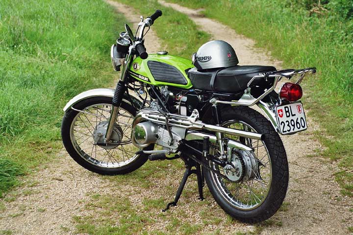

    Yea I have the brake plate that goes right in, but the speedo drive is incorporated in the spacer on the other side. There isn't the room for such a spacer. Drive is tapped from the same side as the lever on std setup. Oh well,
    Stinger
    http://www.vintagebike.co.uk/wp-cont...25-stinger.jpg
    GT185 although it looks some models have a torque arm or a tab
    http://thmb.inkfrog.com/thumbn/indep....JPG=450&gap=1
    the GN250 is on the off side.
