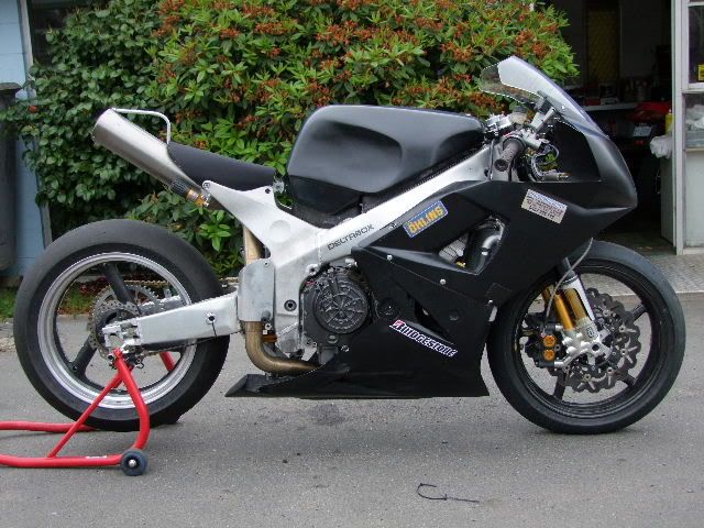

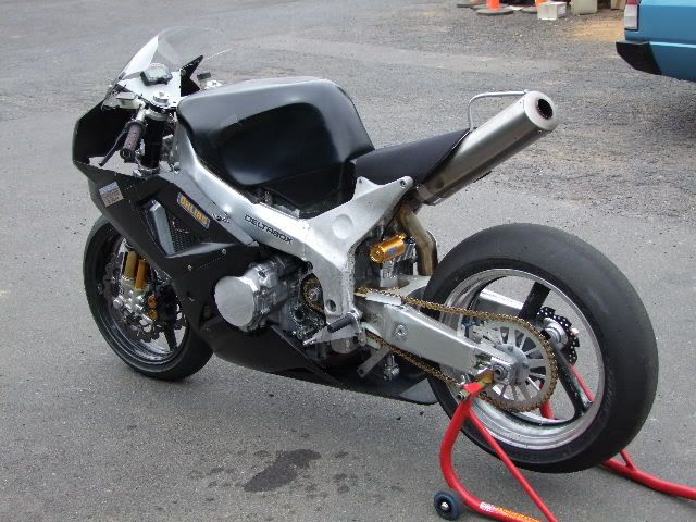

    Came across this in my travels, guy from the UK.
    Built this one about 9 yrs ago and shes on her second frame and third engine.Very much a bitza and a work in progress.
    Basicly its a fzr 400rrsp frame/ swingarm with a 98 900 fireblade engine.Great fit with a little work.152kg wet and 150hp rw.
    Specs:
    997 je piston kit
    39mm keihin flatslides
    akro exhaust,custom tailpipe
    Sealed ramair airbox
    Retains electric start with total loss battery
    alternator removed and lightened starter clutch
    reprofiled standard cams/ported
    electric waterpump conversion
    10L carbon fueltank (fits behind airbox with a dummy cover)
    Zx636 radiator
    Braced/lightened frame
    TTX36 08 ZX10 ohlins shock
    Custom linear shock linkage
    fgr700 ohlins forks using 02r1 fork outers too fit 02r1 triples.
    Thumb rear brake lever
    Bst front wheel/tz250 rear wheel and rear brake,oh! and a strengthed cushdrive.
    braking rotors/r6 calipers
    Brembo 19/18 mastercylinder
    Triumph 650 daytona race fairings
