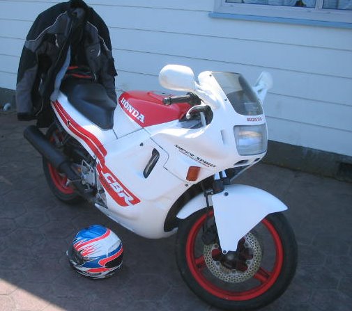

    yip i made a new top fairing for my cbr600 out of fiber glass.
    old was was toast, we made a mould and went to it.
    came out good as.
