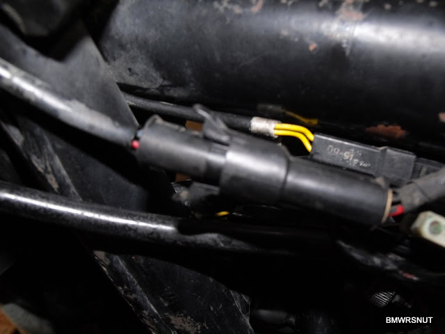

    I have a front brake - rear light will not work when I squeeze brake lever?
    The rear brake light does work when using the foot brake.
    Is the switch possibly faulty or knackered?
    I see that I have to remove tank and undo from brake lever and unplug assembly?
    Could the contacts be loose or worn/corroded?
    Are they bloody expensive and is there a way to test said suspected knackered switch?
    Thanks all.

    There are 2 small 2 pin plugs under the tank, with wiring for those coming from te handlebars. One is the clutch lock out switch, the other the brake light. It's easy for these to get broken apart. Get the tank off & check. Easy.

    Just trying to keep up to date wid' de lingo. I've put up a photo in my late post. Both the clutch & brake switch wiring appear to be yellow to the plug.
